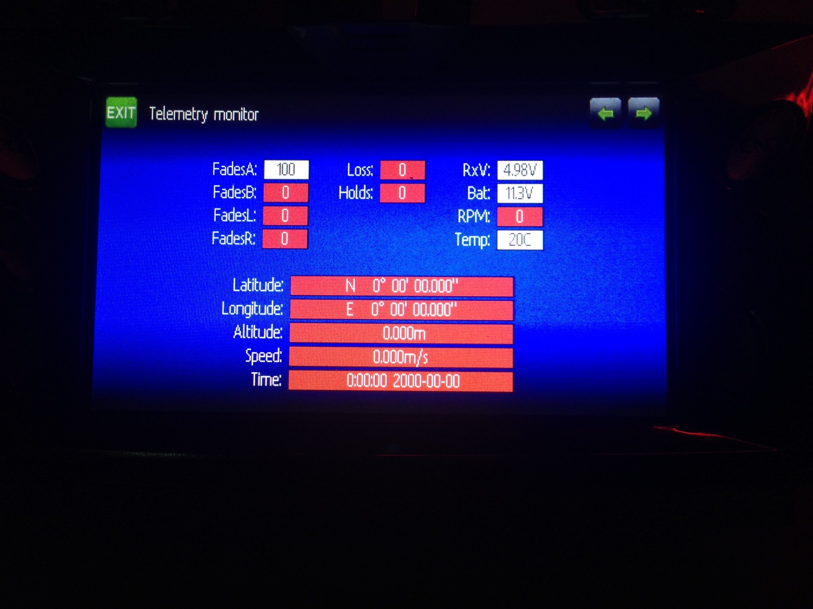

The telemetry data handling is now all 16 bit. With data type conversions removed I'm now expecting only 1 value to represent 'not connected' 65535.
This value (if received) will cause the last real value to change to red.
If no real value is ever received initial value of zero remains. Real values are displayed in white and if nothing received for some time, will to change to red.

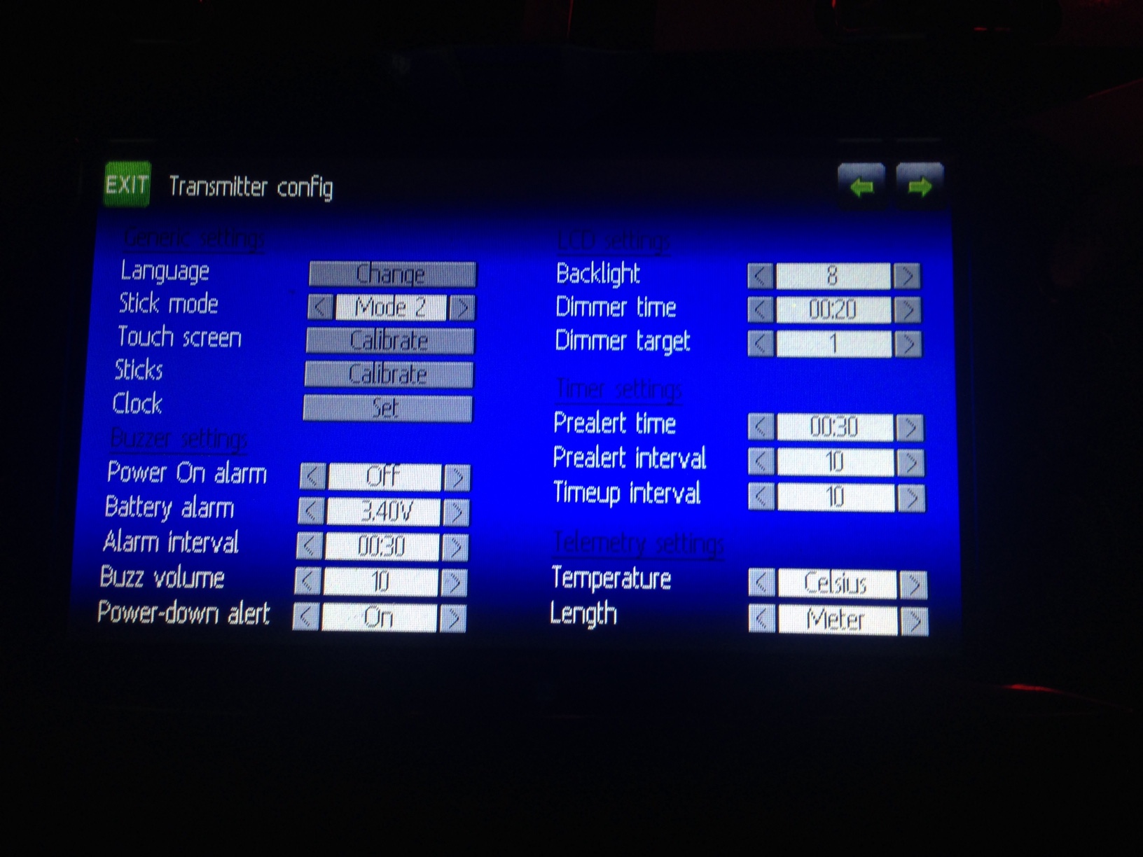

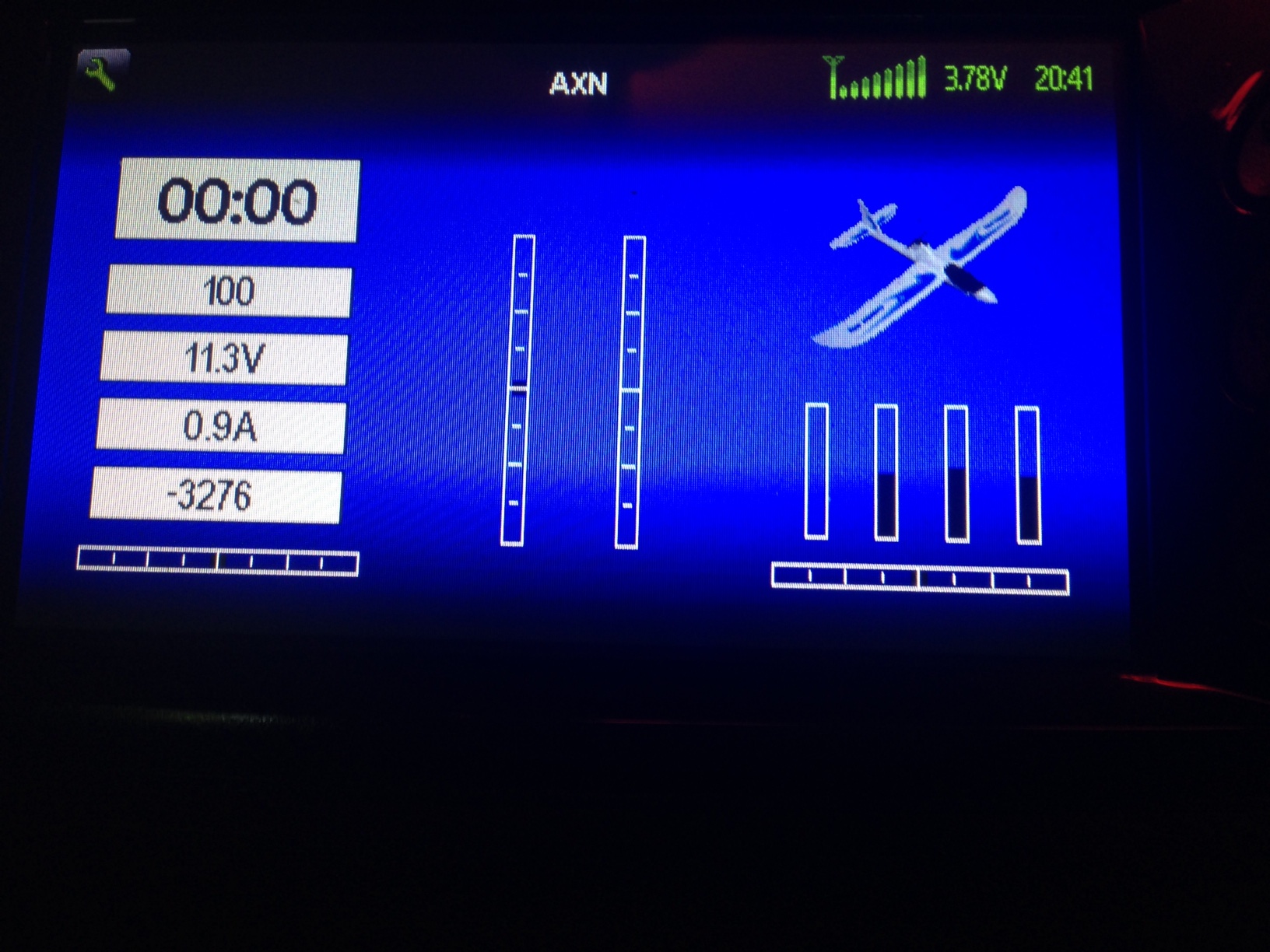

Hi all - evening. I've flashed your latest version indigo, and have given it a quick test. All appears to be functioning as expected, the dancing red values are displayed correctly now, although I'm still getting a high negative value on my altitude? Screenshot attached. -3276 is the figure! If it helps, I get readings down to 0, I think -0.4, then bang, -3276.
I've also noticed that the distance setting appears broken in the main menu - my altitude value is identical whether set to meters or feet - I've attached the box so you can see what I'm on about!
Can't find any other snags within the software as its been put out.

Thanks for that. It's good to see that its working quiet well.
I can't explain the altitude suddenly going to large negative value. Could it be a alarm value triggered after a certain amount of negative altitude?
If it also occurs at different positive height ranges then it would be caused by data being transmitted in a special format and I'm not applying the right type of data conversion to it. Please tell me which which sensor you have?
The 16/32 bit code not working problem I have now solved. There was an error in the checksum calculated during binding. With a wrong initial checksum all data packets sent after that would be invalid, which explains why it would bind but then not respond to any inputs.
The meters and feet will be fixed in next release.
Occasionally you will get wrong data displayed briefly. I am currently trying to solve this issue.
Next release will most likely be in a day or two from now.
