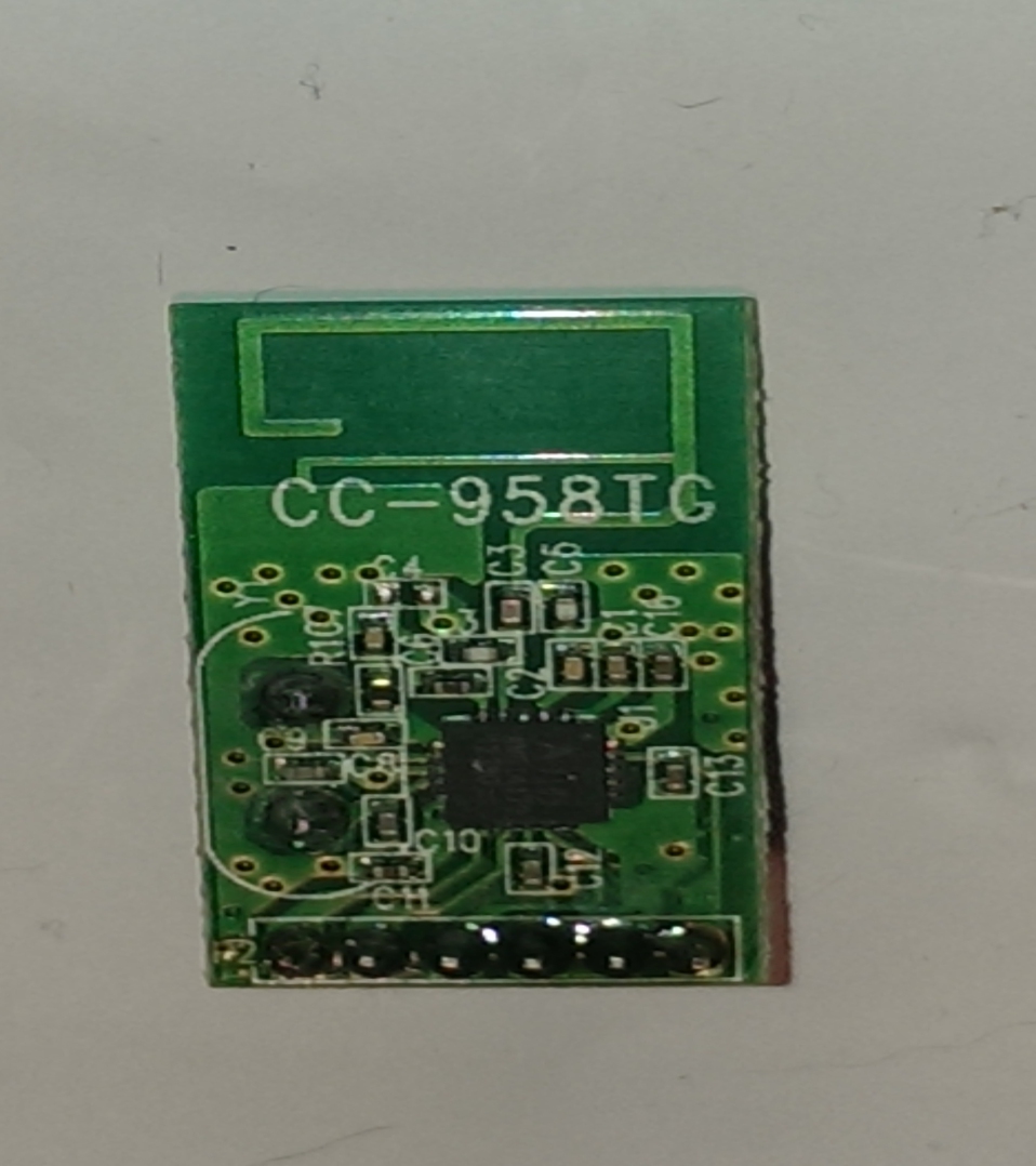

new blue A7105 installed in new 7e, cant bind
18 Feb 2015 04:33 - 18 Feb 2015 04:37 #28785 by Cereal_Killer
new blue A7105 installed in new 7e, cant bind was created by Cereal_Killer
Hello folks, first off I'm new to DEVO and programmable Tx's in general (and pretty new to RC as well) but I'm not at all new to computers, FW / HW mods and micro's of all types. I got my final parts today, I've been doing research for the last 2 weeks while my 7E was on order and read all I could. Today I quickly breezed threw the install and range mod (I am a electrical engineer by trade and literally do SMD hot air reflow soldering as part of my every day work load, I consider myself an excellent solderer and knocked the physical labor out in a couple minutes time). I completed the FW flashing, modded the tx file as needed to enable to A7105 module with PA on A14 (I also modded the 7E to use a real antenna I hooked straight to the A7105 module while I was in there).
I loaded up model config files for both models I was hoping to have flying with the devo, my V911 and my proto-X. I went in and set the fixed ID to none on both of them yet I just can not get it to even bind, let alone control anything.
I've been troubleshooting a few hours now and I cant go any further, I just dont know enough. I've poured threw the manual cover to cover but it seems to assume you have a working knowledge of programmable tx's which I just do not have. I dont even know what the normal bind procedure is, which is really why I set the ID to zero hoping to just be able to switch it on and have it bind. The "Bind button" talk I dont understand at all what is this "bind button"?!
I have verified the module is getting 3.3v and GND, however I'm wondering if this new blue board could be a different pin order than the pictured green board here making my data wiring backwards?
www.hacksmods.com/tag/devo-7e/
Can someone instruct me the most basic bind procedures? Should I go ahead and set the Fixed ID to some number (if so what?) and then do some sort of stick commands or button presses or something to try and make it bind (again please be specific, I dont know what I'm doing here)? Also when I am in the model setup menu and I go to the Re-Init button, should that be an option I can choose? Cause I definitely cant select that... (sorry for such general questions, this should be easy for me but I've literally been messing with it for hours now)
Do I need to try and source another A7105 module, either the green one pictured or the new style or should this blue one work? Sorry I dont have pictures of the blue board tonight, if they're needed I can post them in the morning.

BTW here's a few pic's
Blue A7105 module
Installed
Antenna (excuse the cluttery desk)

Ok, I can't figure out how you decided that the Blue module was compatible with another one you had, so maybe you can help me out.
I've got a CC-958TG, about which the only thing I can find is an assertion on rcgroups that it's compatible with the WLToys A7105 modules. But I can't tell how you'd determine that.
I can tell that it's got an A7105 chip, and an on-board antenna like the XL7105-SY, but the same pin count and crystal (on the otherwise blank back) as the WLToys modules. Any chance you can tell me whether or not it's compatible with the WLToys pins?

This is the pic I looked at to determine it had the PA installed (the extra parts on top), is that not the PA?
http://www.hacksmods.com/2013/04/walkera-devo-7e-transmitter-deviationx-flysky-hubsan-mod/hacksmods_devo7e_flysky_v929_v949_v959_hubsan_x4_deviationx_module_mod/#lightbox[1388]/0/
(Direct image may not work but link should be clickable)

mwm wrote: Ok, I can't figure out how you decided that the Blue module was compatible with another one you had, so maybe you can help me out.
I can definitely help you out with this now that I'm to my computer for the day but I need a better pic, the glare from the slight angle hides the traces. If you can get a perfectly straight on pic of the front and back (preferable with the header down in both pic's) I can tell you the pinout!

I don't know - I'm a software guy, with just enough hardware skills to let out the magic smoke. However, PBR's module list implies that the XL7105-D03 is the only one with a power amp.
I don't believe there's any harm in turning it on if you have don't one, or not turning it on if you do. However, indicating you have one enables the power options in the model config, and we don't want people using that when it doesn't actually do anything.
So you should be able to find out for sure by enabling it and range testing the different power levels. If you do, let us know what you find out.
BTW, that link answered my questions about the CC-958TG module. Thank you!
