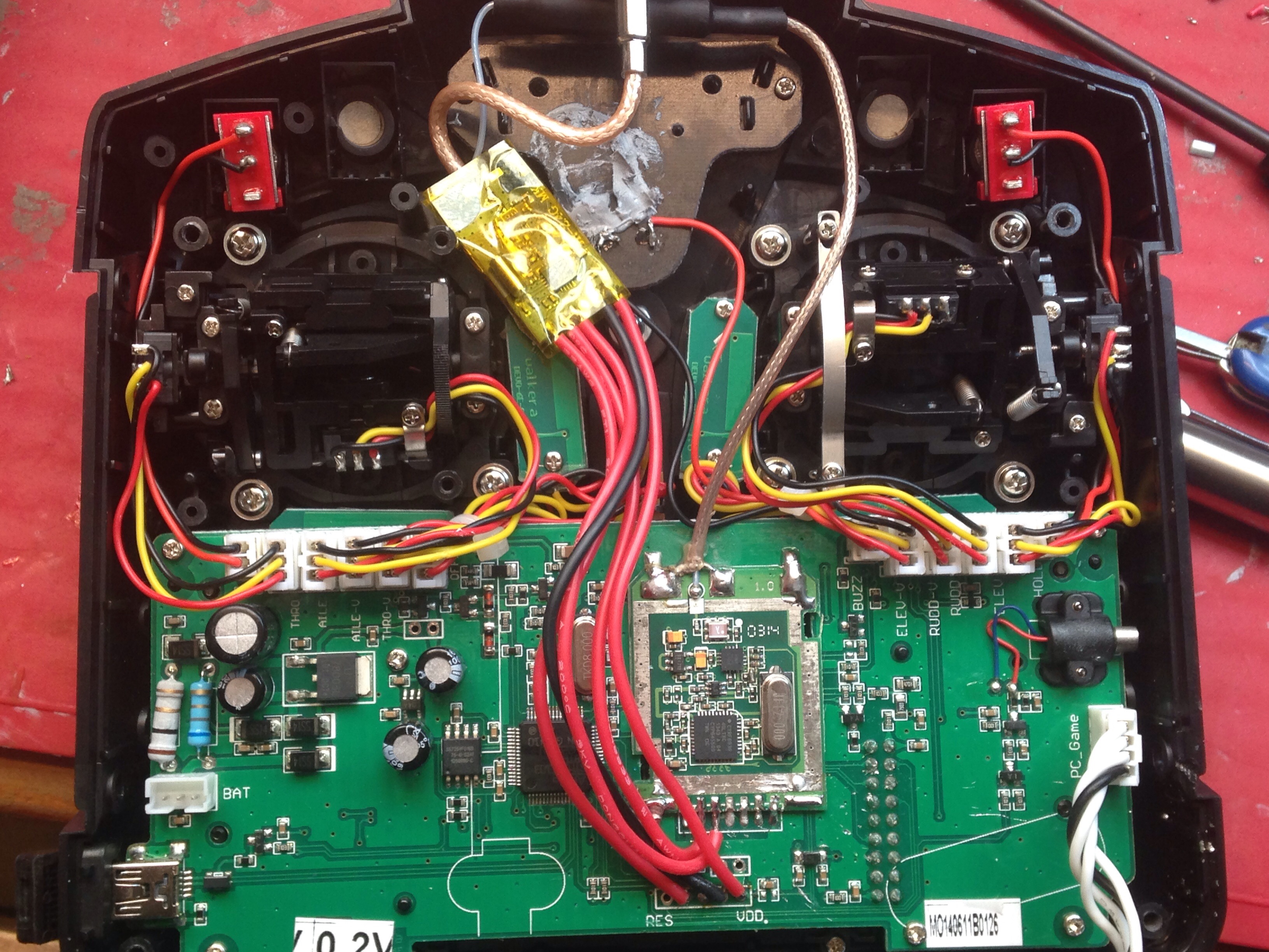

21 Feb 2015 02:15 - 21 Feb 2015 02:16 #28940 by Cereal_Killer
Replied by Cereal_Killer on topic A plan: Swapping NRF24L01 Modules?
About the second module- yes they share pins except for the data pin, on the single row header (where VDD is on the right end) you can connect one to the (numbering L->R) holes 2 and 3, you just have to make sure you set them correct, one is A13 and one is A14).
Note there are multiple VDD and GND via's open so you won't have to stack those on eachother. Oh and for GND you don't have to use the right most pin on the stock module, again there are several GND vias and other GND locations closer to where the modules fit.
Here's mine, th black wire is GND, I used 22AWG silicone wire cause it doesn't melt like jumper wires do.
i452.photobucket.com/albums/qq247/1badv8...124-7947338A521E.jpg
