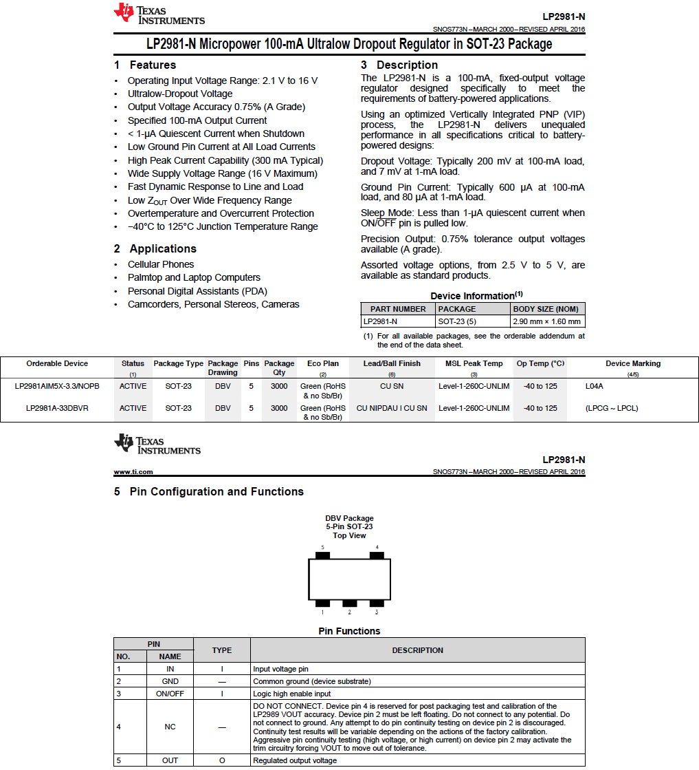

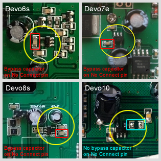

I was looking at the power regulators that I had in my transmitter (7e) prior to adding more RF modules to better understand the load that could be put on it. The part number I had on the 3.3v regulator is "LPCL" which I believe is the Texas Instruments LP2981 rated for 100mA and capable of an input voltage of up to 16v. This seemed really low for powering the entire transmitter so I started searching for other regulators as well as looking at the regulation circuitry onboard. This led to a few interesting discoveries (for me at least), so I decided to ask here in hopes of getting more information to see if there is a better way to power everything.
1. Bypass Capacitor on Pin 4
There is a bypass capacitor on pin 4 of the power regulator, but the manufacturer's data sheet explicitly states (and warns) that the pin should be left floating. This indicated to me that Walkera may have designed the circuit for a different regulator and due to cost or supply reasons decided to put the LP2981 in instead, but didn't quite fix things for pin compatibility. I also took a look at the other Devos to see how their circuits are, and from the various pictures floating around I could only find 2 part numbers "LPCL" and "L04A", both of which are the LP2981. Also in all the pictures, it shows a bypass capacitor on pin 4. Except for the one picture from our download area of the Devo10 which seems to have the capacitor omitted or removed.
Given the pin configuration and the various capacitors making up the circuit, I believe that we can drop in a LP2985 (150mA) or the MIC5219 (500mA). I'm leaning towards replacing the regulator (with the MIC5219) as opposed to removing the capacitor as I believe the extra bypass capacitor will reduce noise within the circuit.
(Question) I'd like to know if any of you have a different part number on your regulator that might indicate to us the original part that Walkera had designed for.

Pictures of the interesting bits:

04 May 2016 18:15 #47756 by silpstream
Replied by silpstream on topic Devo power regulators
YJ wrote: In the mean time, I'm starting to think, while this seems a good fit for NiMH batteries, if using Lipo, the LDO in the Cypress module will still be stressed by the high input voltage (raw voltage - ~1v), so a 5V step down is probably needed for the cypress module.
You're probably right about voltage being too high if using a lipo. Would be interesting to see how we can do that while still maintaining the stock regulator and being able to keep VBAT reading for deviation. Might be possible if we can find the right items to desolder or traces to cut.

Fernandez wrote: I do notnunderstand term "bypass capacitor".
It is also known as a decoupling capacitor. Try here: https://en.wikipedia.org/wiki/Decoupling_capacitor
Fernandez wrote: To me the pin may not be connected to potential means dc. The capacitor is just to ensure the pin is free of any noise and not pick up any rf signals.
I'm not sure if it is that simplistic. The data sheet doesn't show a block diagram of whats behind the "NC" pin (pin4), thus I can't really say how it will get affected. Current may not flow in the traditional sense through this capacitor, but I believe there will still be a potential across it. (I hate figuring electronics versus physics for capacitors... :lol: ) In general if the reference application from the data sheet says NC, I normally leave it literally not connected, but that's just me.
04 May 2016 19:01 #47761 by HappyHarry
Replied by HappyHarry on topic Devo power regulators
yeah it clearly states no potential, no ground. though it also states that it's used for calibration/adjustment perhaps they were off the 3.3v and these caps correct this? but I'm pretty much a newb electronics wise so don't beat me if I'm wrong lol

HappyHarry wrote: yeah it clearly states no potential, no ground. though it also states that it's used for calibration/adjustment perhaps they were off the 3.3v and these caps correct this? but I'm pretty much a newb electronics wise so don't beat me if I'm wrong lol
I'm quite sure the capacitor is not there to help correct for 3.3v... lol
