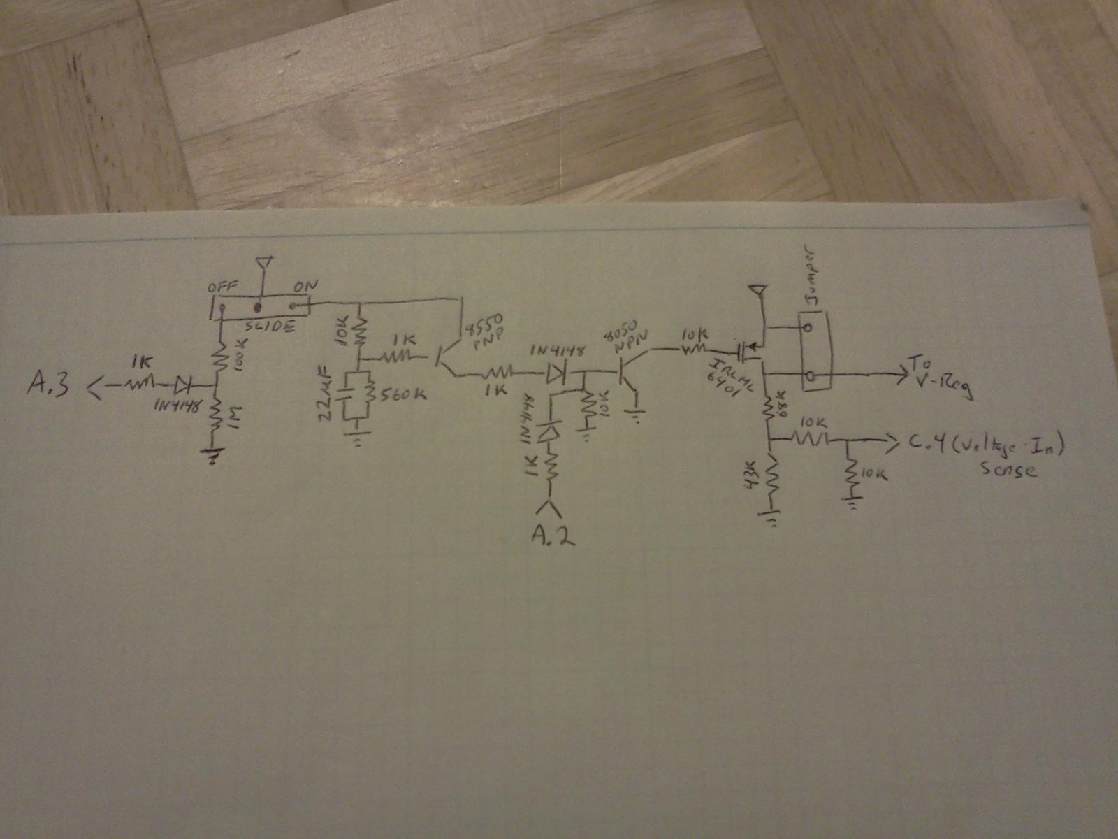

vlad_vy wrote: Near DC IN connector on the mainboard there are two pads in rectangle, you can bypass electronic switch by connecting these two pads. If transmitter will work with connected pads, most likely you will need replace IRLML6401 TRPBF 01AH MOSFET (to the right from rectangle).
Devo8 power circuit:
please show in the image which component should I jumper & which component should I replace.
thanks.
26 Aug 2019 04:32 - 26 Aug 2019 04:38 #75004
Replied by vlad_vy on topic Devo power regulators
To check if voltage regulator is working you should connect pads in rectangle with label "Jumper", it will bypass "Power On" switch and electronic power on switch. And replace MOSFET connected to it. At the right part of the diagram.
Last edit: 26 Aug 2019 04:38 by vlad_vy.

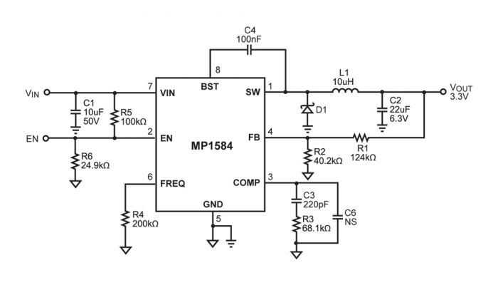

Can you try different 100uF capacitor? I think MP1584 can output 5V, then used LP2981AIM5-3.3 (L04A) to get 3.3V.

In that case something wrong with external components: inductance (round, 150), Schottky diode (SS14), electrolytic capacitor or something else (LDO 3.3V or adjacent LDO unknown V). Output voltage specified by R1 and R2 to FB (Feedback Voltage = 0.8V) on MP1584 diagram.
If you can, try to cut trace from the electrolytic capacitor and resistors to next components (LDO). Near the point with empty place for resistor. And disconnect VTX and RF module.

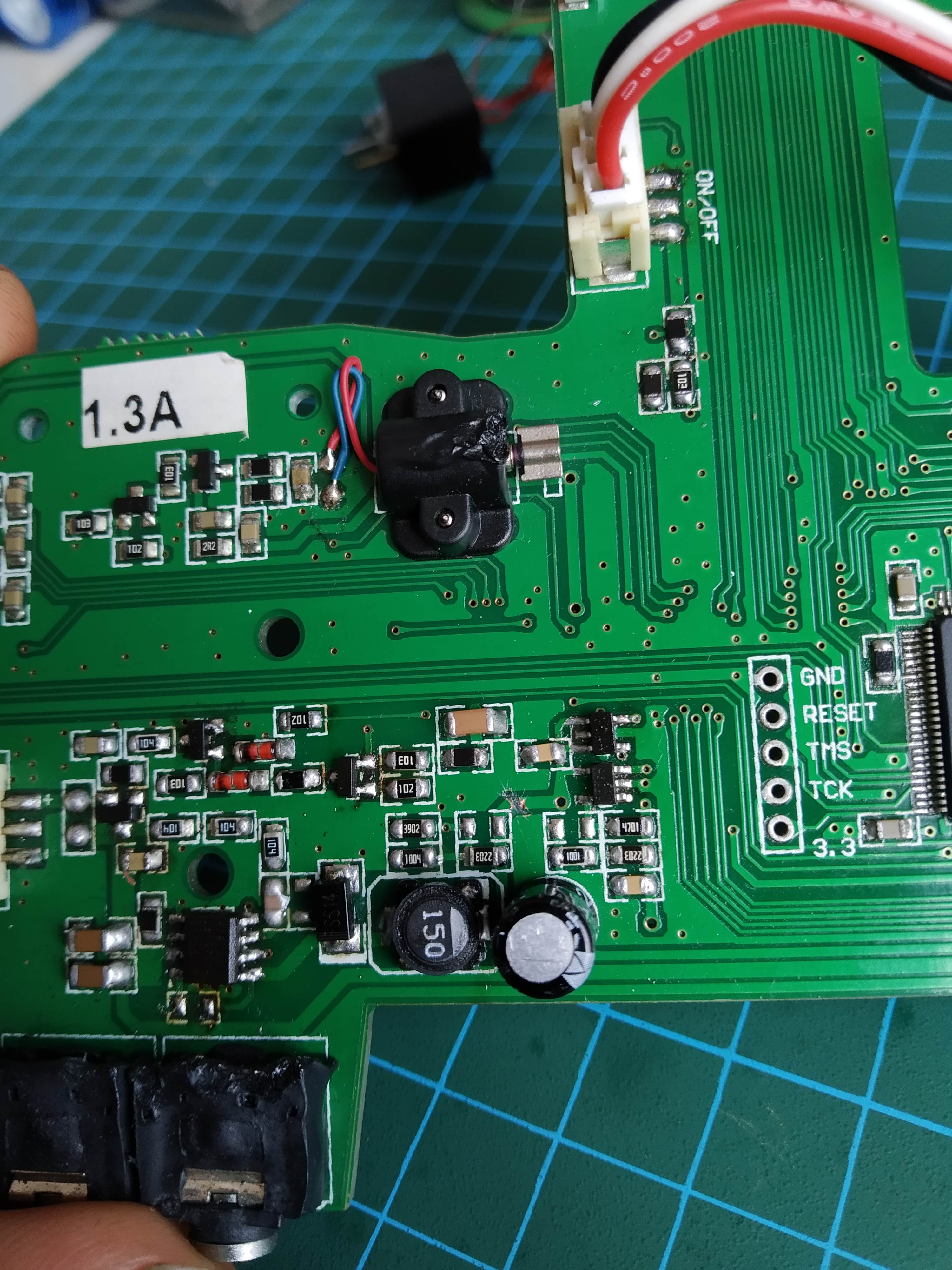

27 Aug 2019 08:12 - 27 Aug 2019 08:17 #75021
by Yon
Replied by Yon on topic Devo power regulators
like this?
Last edit: 27 Aug 2019 08:17 by Yon.
27 Aug 2019 08:30 #75023
Yes, like this.
OK, it seems MP1584 is good, but something else is bad. Have you connected VTX and RF module? Check 5V voltage to VTX and RF module.
