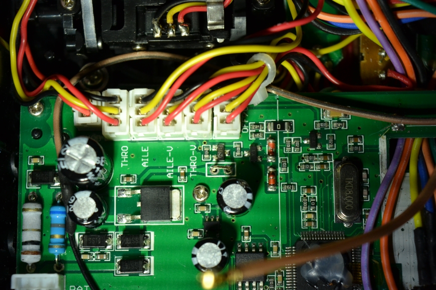

Yeap I blow it up too ! It works if I connect the 2 holes bellow it and unplug - plug battery. Now the power to main module is 4.31V ! but I found 6.24V from the holes down and right !
Which mosfet I should buy ?
Will this be ok? : www.ebay.com/itm/IRF-IRLML6401TR-P-Chann...0:g:o-EAAMXQTT9RwtqG
or this : www.ebay.com/itm/MOSFET-P-MICRO3-Part-IR...9:g:AtcAAOxyd8NSa74x
Any other opinion ?

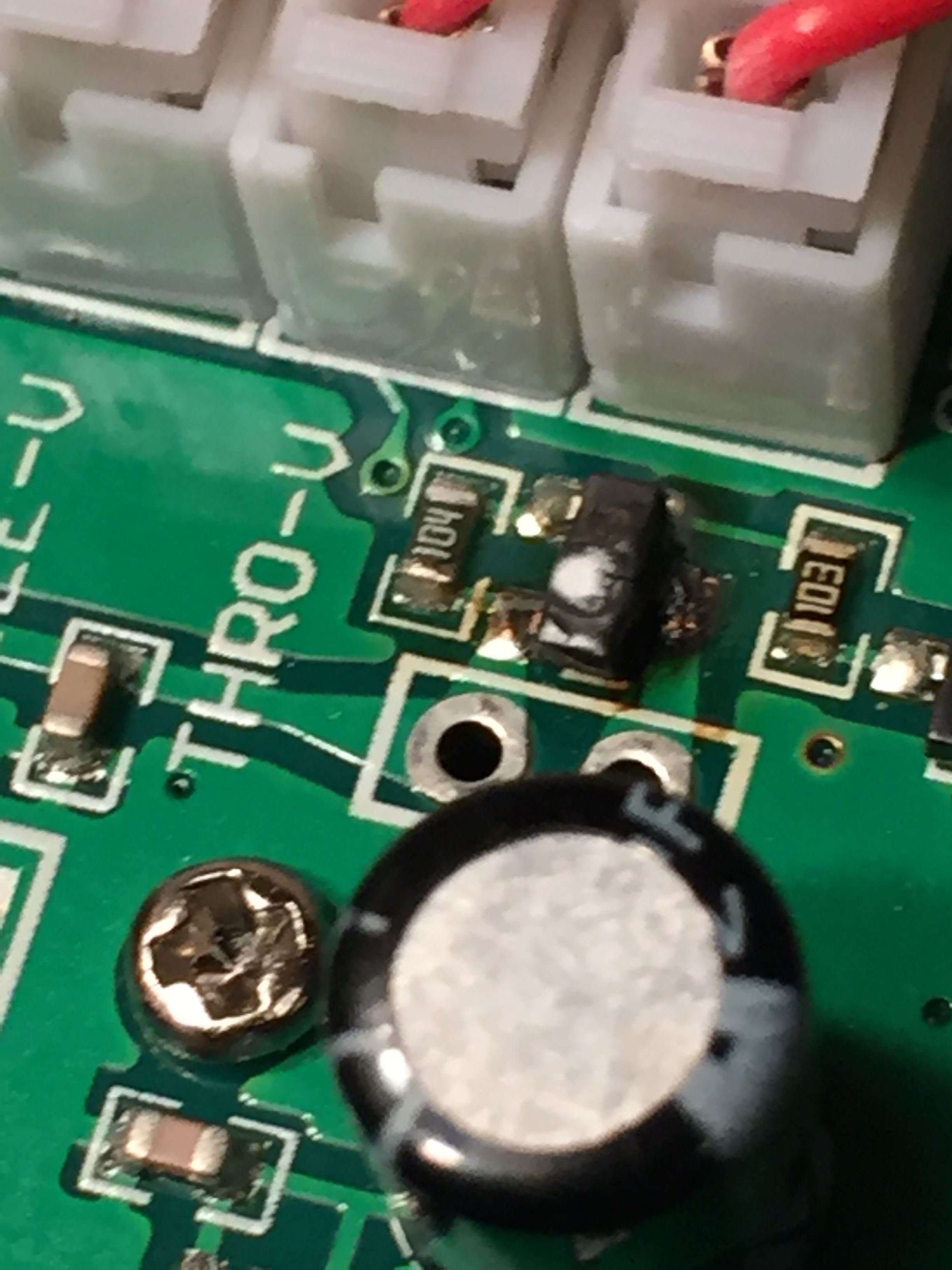

I just had the same issue. I bridged something when fitting the case together. I suspect I bridged the speaker solder points with the heatshield of a 4in1 mod (DOH!).
I have some info and pics in another thread:
www.deviationtx.com/forum/6-general-disc...oked-mainboard#62828
Looking for a suitable replacement transistor. Anyone with experience, please respond with a description and link (preferably for the very amateur electronics tinkerer, as I'm not familiar with specs/numbers and how to interpret them).

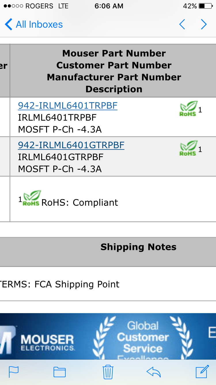

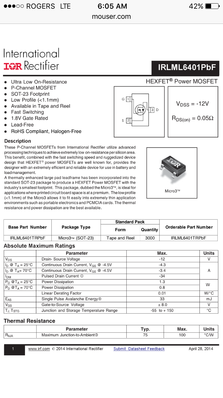

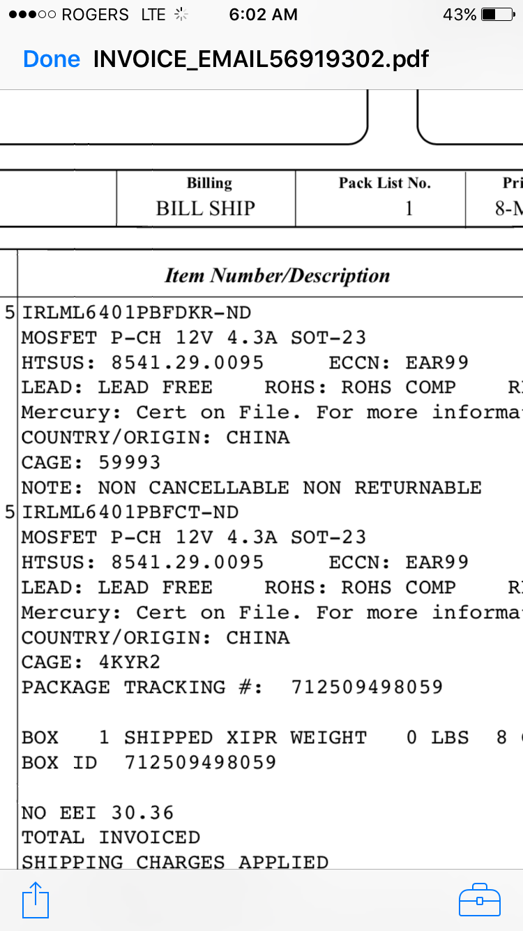

Hello, if you scroll up you will see I had the exact thing happen to me. (Put some heat shrink or tape around your 4in1 once it's fixed
The mouser order I linked are the ones you need.. I ordered a ton but only needed the 1. I believe it's a Pfet or mosfet they call it. I had a local cellphone repair guy do the clean up and soldering. Once replaced all worked great again. Hope this helps!
P.S. I don't know where you are, but I'm in Canada and will ship you a couple of them, just pay the shipping. Let me know. Cheers
