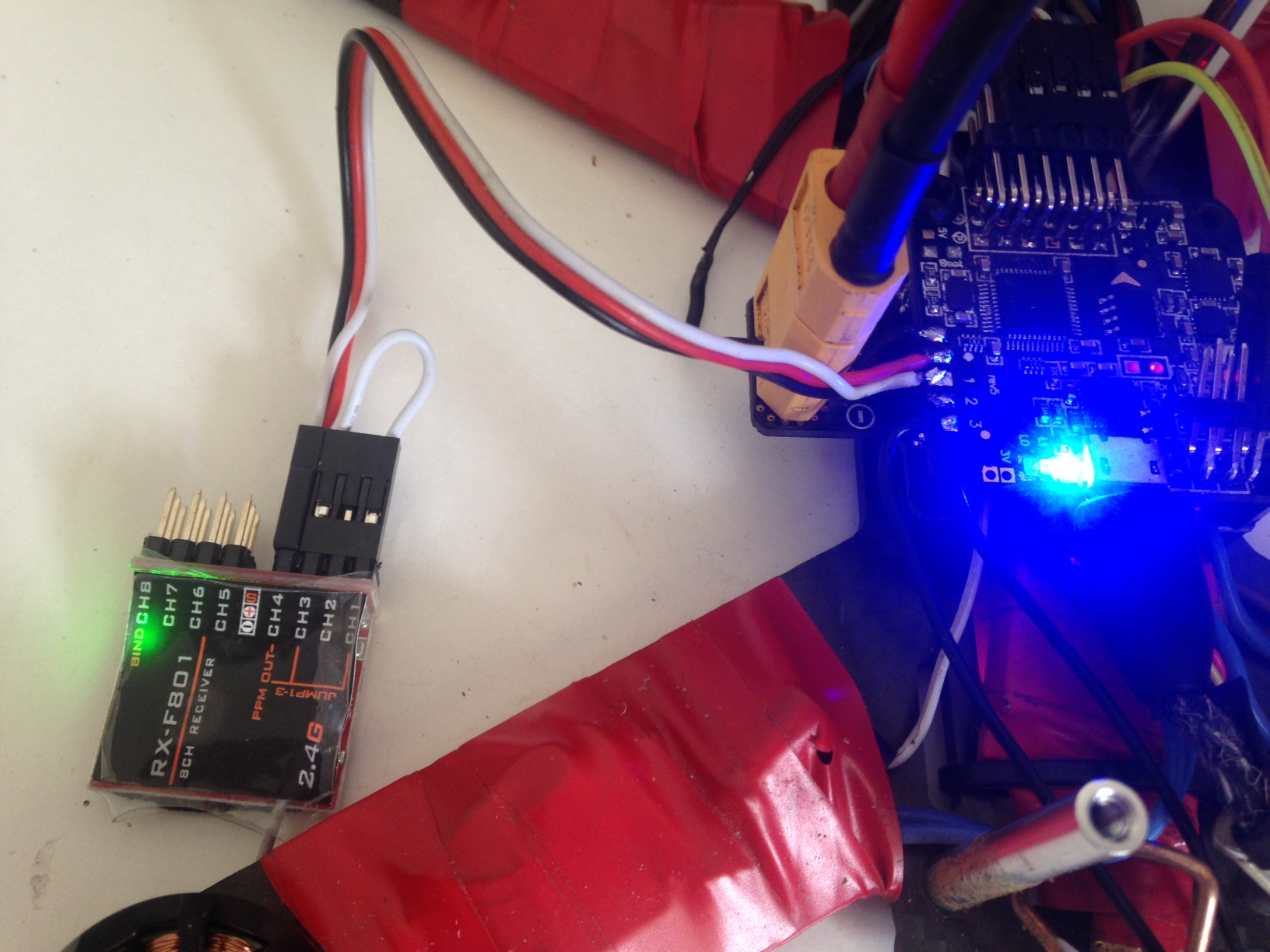

Hello I can not seem to make my RX FrSky(
www.banggood.com/DIY-FRSKY-8CH-Receiver-...FT-DHT-p-987247.html
) RX PPM.
I managed to make it work in PWM
I do not know the sytem PPM with 10 devo how the set? thank you

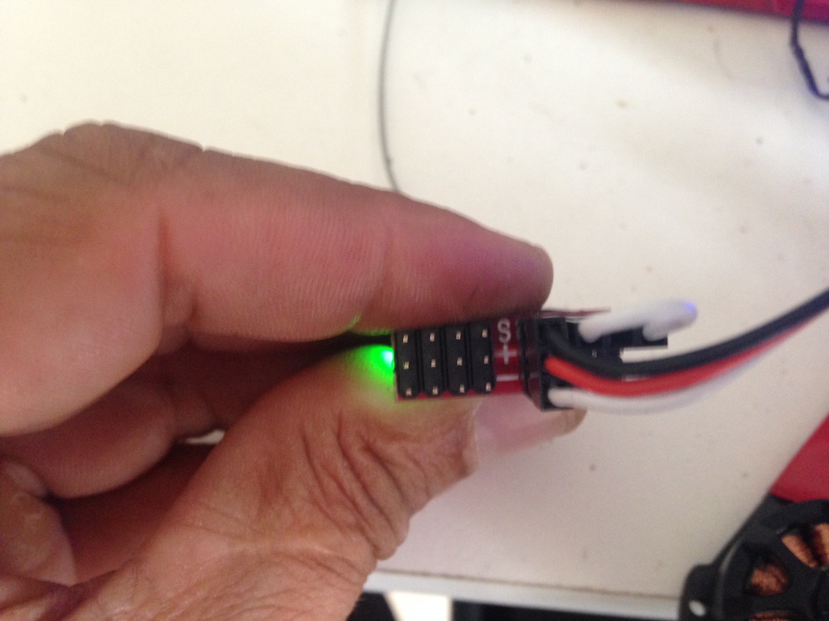

Did you set the plug and the cable on the right pinrow? Looks to me like you have it on the minus row.
The signal lines are on the side where the CC2500 board is.........

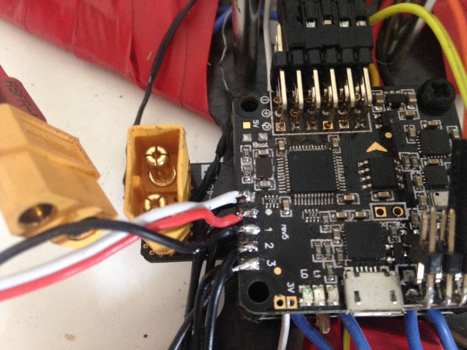

by DJDavid33
Replied by DJDavid33 on topic DIY-FRSKY-8CH Devo 10 help
you talk about the black and white thread
white wire plug on naze32 rev 5 on the 1.
GND black on red on + 5v
I even try to invert the black and white wire

No; I think you did the wrong connection on the receiver.
From Atmel side.> downwards = GND/VCC/ Signal .
C'est bien ça ?
static.rcgroups.net/forums/attachments/6...2361-210-outside.jpg
C'est bien ça ?
Last edit: 05 Aug 2016 13:34 by aMax.

Set the bind plug on signal line 1& 3......and not to the ground pins..DJDavid33 wrote: I also try to reverse the thread from the RX

I redid my soldering
the white wire is GND red wire the + 5V and the black signal
and it works in PWM
and it works in PWM

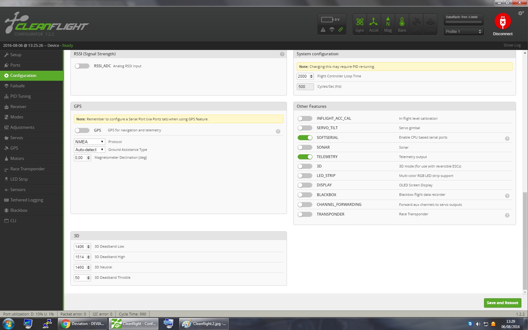

What is the flight controller software?
Did you set it up for PPM-Sum?

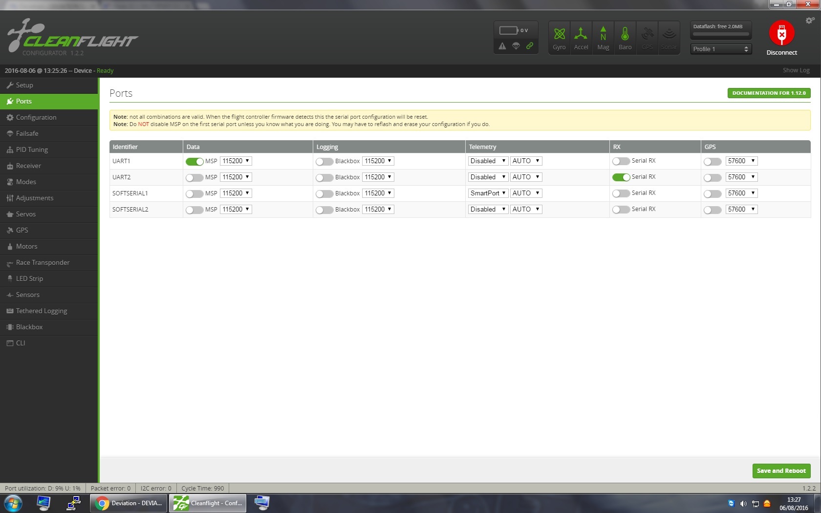

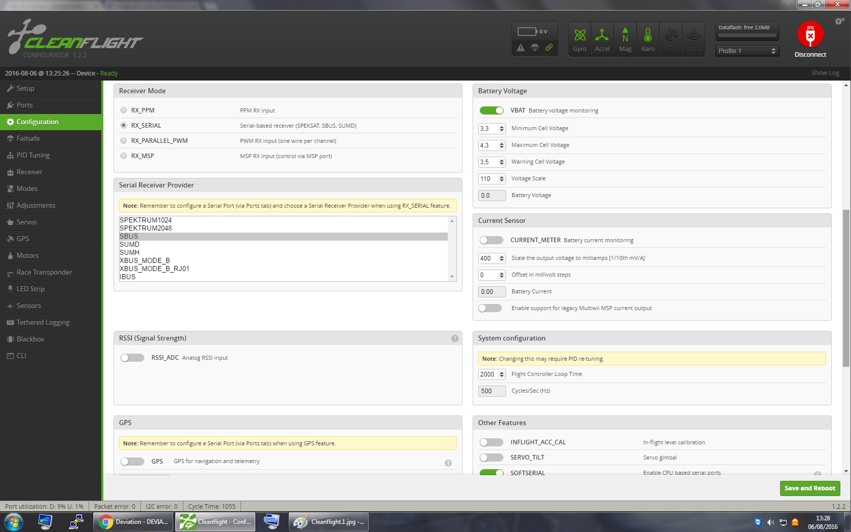

The other option is to set the rx to sbus ( jumper at pin56 and pin7 8), output for the signal is pin5.
First configure on the port menue uart2 for the receiver and choose on the configuration menue > receiver = serial and protocol = sbus.
On the Naze you connect this line to the rx port on uart2. Don´t forget to deactivate the signal inverter!
Do this via CLI command.
This works for Cleanflight and Betaflight. For Baseflight I can`t tell you how to do.
Edit: on the RX 801 there is no out pin(tx) for sbus, Thus you have to do the mod on the Atmel......Sorry

Hello thank you again for your help;)
I use Cleanflight.
PPM-Sum what is it?
I have a naze32 rev5 it does not SBUS or it must make a converter component with what I read.
I use Cleanflight.
PPM-Sum what is it?

PPM_sum or PPM = all channel signals on one wire which is what you need.
For SBus:
If your Naze32 has no inverter for SBus, you can attache the wire straight to RX on UART2 because you got a receiver
which has a noninverted signal.
But as far as I read, there are inverters on Rev5 & Rev6 and If they are active, turn them off. (CLI command)
That´s all.
For SBus:
That´s all.
