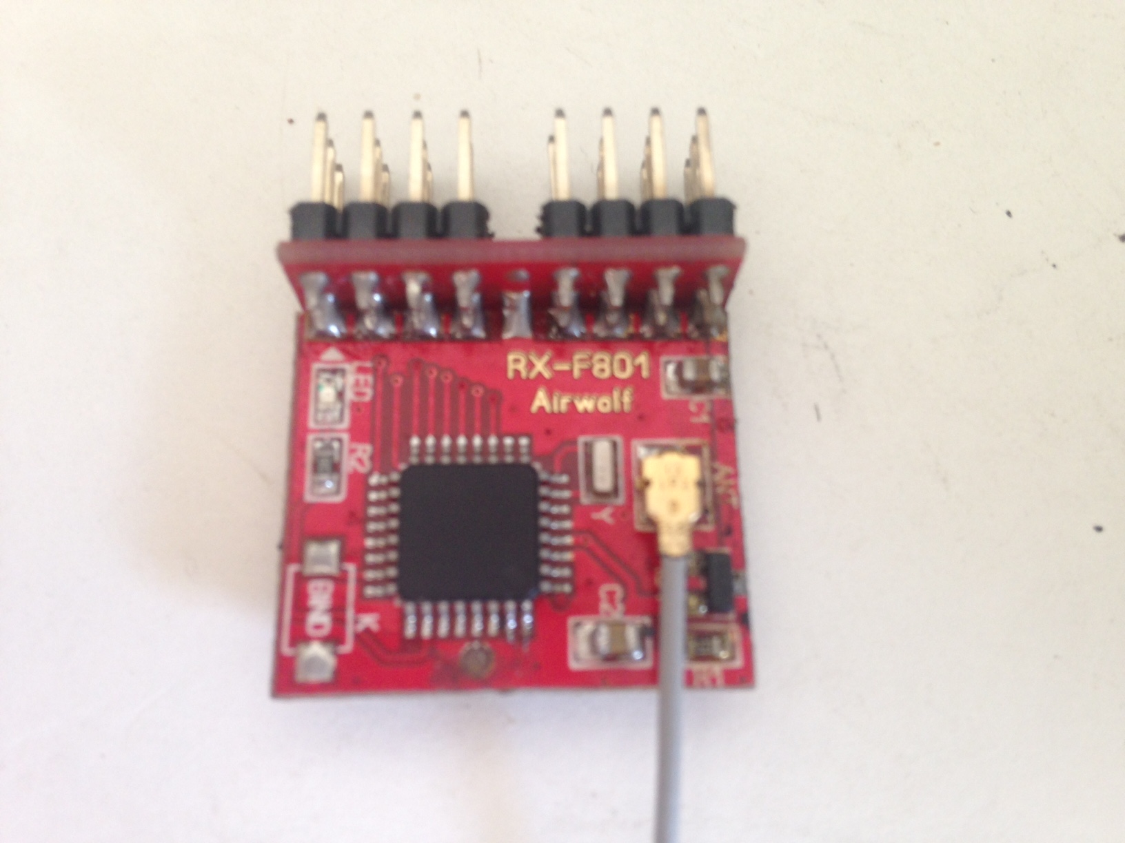

- aMax
- Posts: 776
07 Aug 2016 22:53 #52559
by aMax
Replied by aMax on topic DIY-FRSKY-8CH Devo 10 help
Did you remove the shrink tube from the rx? There is a new board layout, so no need for soldering on the Atmel anymore.
Pads for Sbus and telemetry are already there.
static.rcgroups.net/forums/attachments/1..._0027-cut-small7.JPG

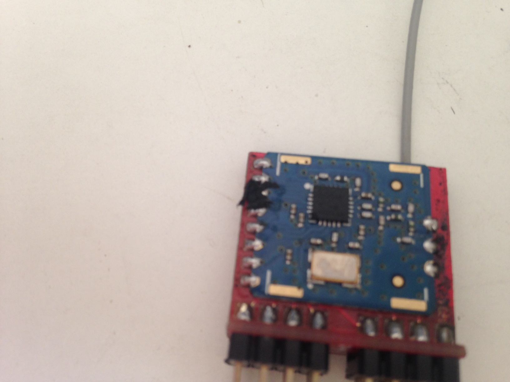

- DJDavid33
- Posts: 74
08 Aug 2016 11:31 #52575
by DJDavid33
Replied by DJDavid33 on topic DIY-FRSKY-8CH Devo 10 help
hello mine is different I have to weld for the SBus
- aMax
- Posts: 776
08 Aug 2016 16:57 #52589
by aMax
OK.
Old board; new sticker.....in the meantime they have been sending this little rx even with a small case.
To get this project running, I would advise to keep it simple and go with PPM first
This will free uart2 for something else, e.g. bluetooth. Later on, if all is working as expected, you can switch to sbus......if necessary.
