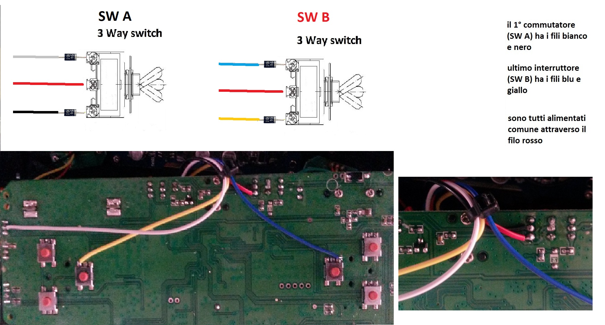

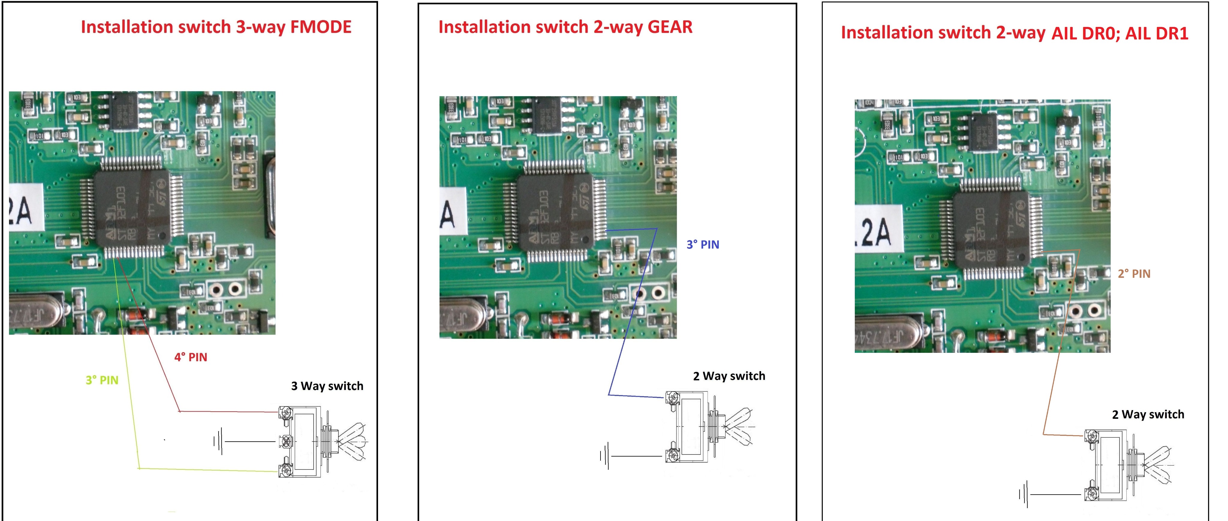

- LucaG
- Posts: 29
20 Apr 2017 18:41 #61621
by LucaG
Replied by LucaG on topic Devo F4 additional channels
Attached some schemes.
This is the clue I did by reading what Epitaph has posted.
www.deviationtx.com/forum/7-development/...or-devo-f4?start=300
These are schemes that have NOT been confirmed.
On HOLD0 / HOLD1 and MIX0 / MIX1 / MIX2 switches I'm looking for information! Can someone help me?
I ask anyone to confirm or comment! Thank you
