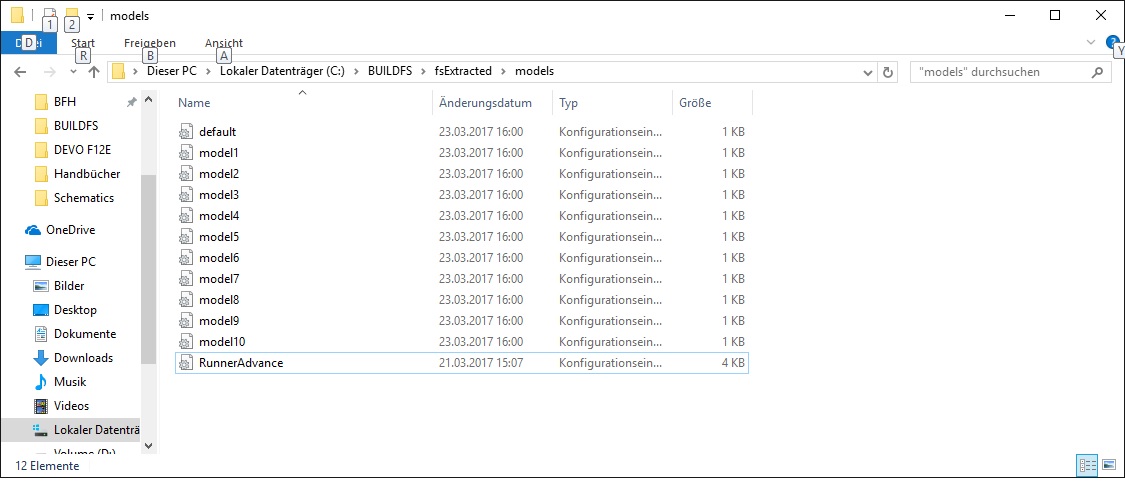

Ok, thank you! I hope i will get this sooner than i will have assembled the new racer
If someone got an idea what i did wrong pls provide it, it would be cool if i could import new models just like that...

Have you already tried to extract Diggidy's devo.fs?

Just tried it! IT WORKS!!
So i will just use this one as base
I don't get why mine didn't work... but ok...
Edit:
Packing a new one works too
Thank you both a lot!

That RunnerAdvance.ini should be renamed to modelXX.ini in order to be able to load it.
You load a model from the model setup page selecting the "Load..." button.

Well, i thought it is a stupid idea to rename it ^^ But well that worked xD
Thanks again, now i got the basics
