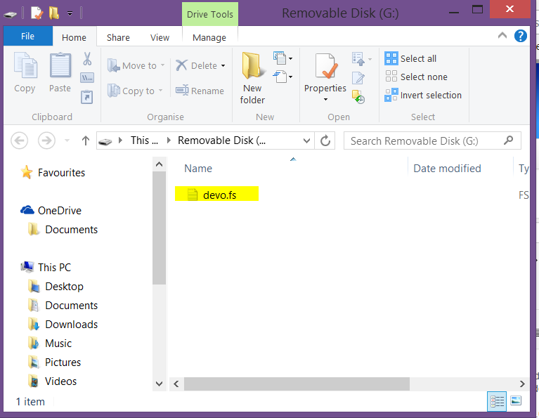

02 Mar 2017 17:34 #59774 by M8A4X
Replied by M8A4X on topic Devo F12E Installation confusion
Hi!
You did everything the right way.
Because of size limitation of the standard flash chip of the Devo F12E an absolute highly skilled member of this forum, PhracturedBlue, wrote a special filesystem for it. The only file which is present on the DevoF12E is the devo.fs you see after installing deviation.
To get the files and folders you mention you have to copy the devo.fs file to your PC and "decompress" it by the use of "Buildfs.exe". You can find more information about that for example in this thread:
www.deviationtx.com/forum/3-feedback-que...oblem-upgrading-f12e
(seems like I can't paste a link here ob my mobile phone... so just copy and paste the url above)
After decompressing you can find the files and folders, alter them, rebuild a new devo.fs and copy that one to your TX (no formatting, only delete the original devo.fs on your TX). Thats it!
The 4in1 module installation is also a very doable task. The needed information can also be found in various threads here.
Also a very skilled member here, Vlad_vy, managed to install a bigger sized flash storage chip to enable more functionality on the F12E, search for "Ultimate F12E" thread.
But for now just try to get the devo.fs file decompressed and readable on your PC.

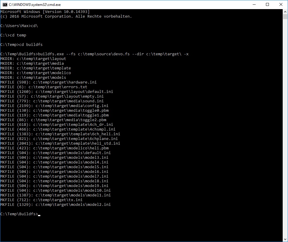

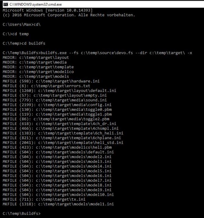

@Quietsch:
Just as an example for using the buildfs.exe look at the screenshots.
The first one shows where and which folders I had placed on my PC, buildfs.exe is in the buildfs folder, in source the "raw" devo.fs file is located, the extracted files went into the target folder.
Hope this helps.

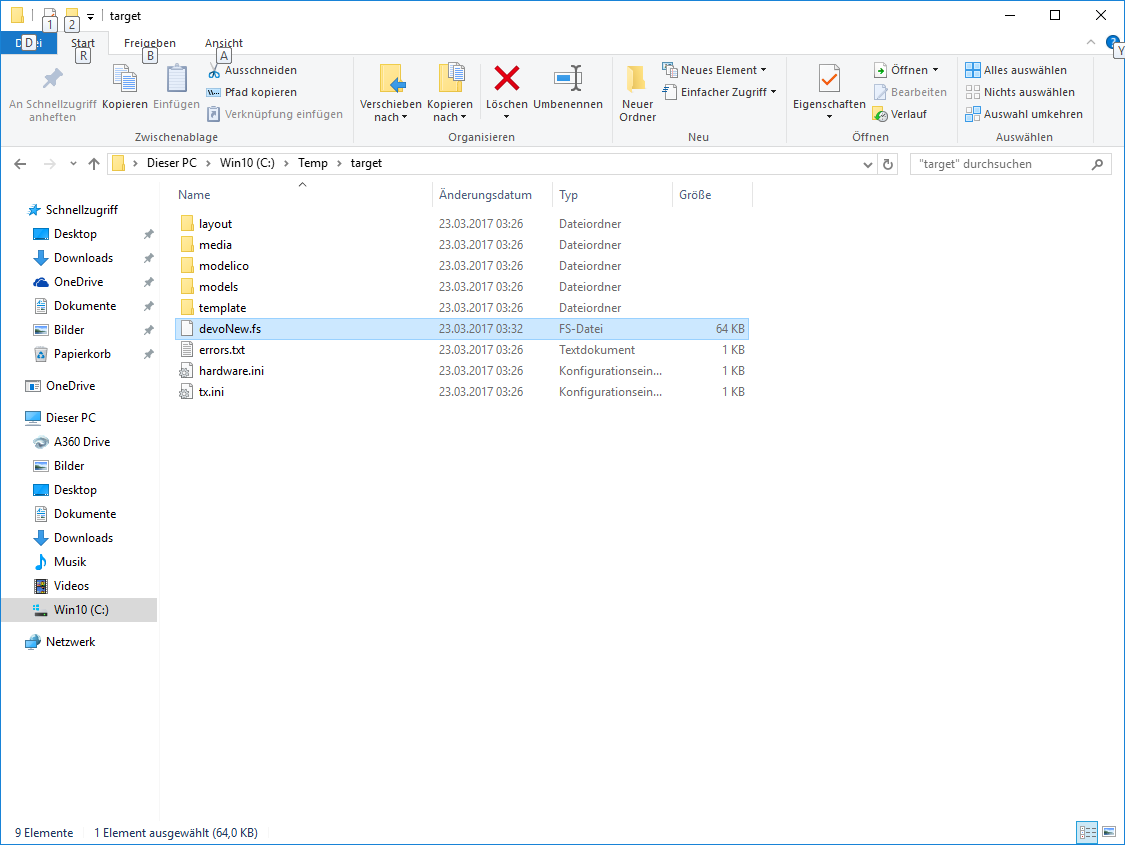

23 Mar 2017 02:45 #60585 by M8A4X
Correct, you have to run buildfs.exe through CMD.
In general it doesn´t matter where you put the buildfs.exe file, as long as your CMD commands do correspond.
For example when creating these folders and placing the files as follows:
C:\temp\buildfs\ --> put the buildfs.exe in this folder
C:\temp\source\ --> put the raw devo.fs from your transmitter in this folder
C:\temp\target\ --> in this folder the extracted files should be placed by buildfs.exe
Now the CMD commands should be the following:
run CMD, change current directory to the buildfs folder by
"cd\" from anywhere it starts (as long as you start from somewhere on your C: Drive) --> CMD goes to c:\
"cd temp" followed by "cd buildfs" --> this will bring you to the folder where the buildfs.exe is located

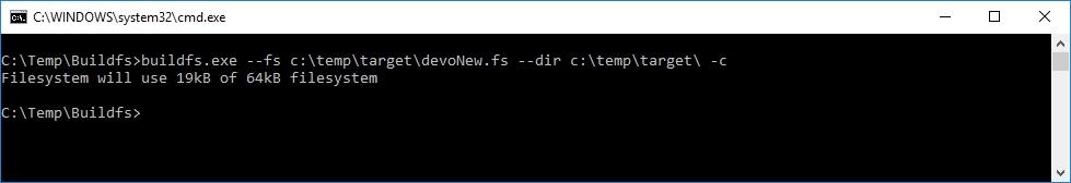

To extract the files in the raw devo.fs file (see attachment step1):
"buildfs.exe --fs c:\temp\source\devo.fs --dir c:\temp\target\ -x" --> buildfs.exe will run and put the extracted files in folder target
Now modify the files you need like hardware.ini and/or model.ini, save them to this location
To create a new devo.fs file with the modified files as content (see attachment step2):
"buildfs.exe --fs c:\temp\target\devoNew.fs --dir c:\temp\target\ -c"
The new devo.fs file (in the example called "devoNew.fs") is the located in the target folder, see attachment step3).
Now rename the "devoNew.fs" to "devo.fs", delete the existing "devo.fs" from your transmitter and copy over the new one.
Done! ;)

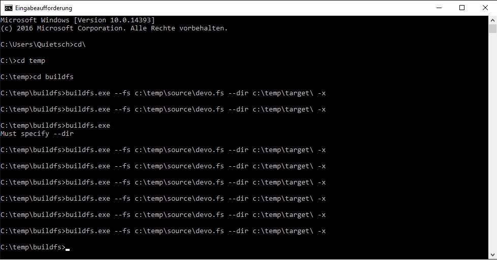

23 Mar 2017 09:09 - 23 Mar 2017 09:20 #60589 by Quietsch
Replied by Quietsch on topic Devo F12E Installation confusion
I always get one step closer to the goal put when i think i got it there is another little problem :P
Thanks to you i can now open the folder in cmd, when i hit the command to extract it there doens't seem to change something (see attachment).
I just made a new folder under C:\ named it temp... Do i have to change the parameters in the attachment?
And why don't i get any outputs? At least an error message?

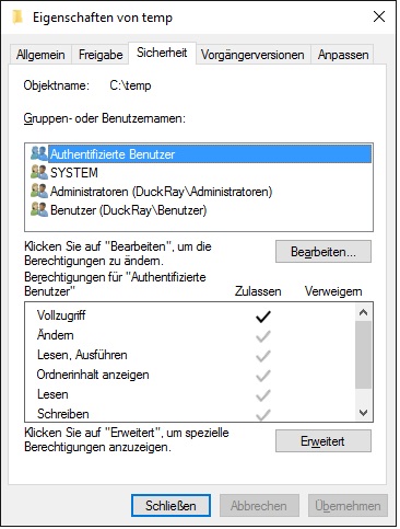

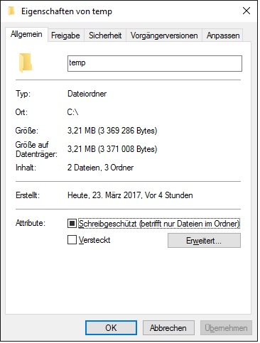

23 Mar 2017 12:04 - 23 Mar 2017 12:05 #60599 by Quietsch
I checked the folder, nothing in it...
Here are the Screenshots of temp. The read-only box i tried to clear but it always got this square in it...
I hope you don't think i am stupid... xD
Last edit: 23 Mar 2017 12:05 by Quietsch.
23 Mar 2017 12:18 #60600 by DIGGIDY
Replied by DIGGIDY on topic Devo F12E Installation confusion
Try running the cmd window as administrator with the right-click "Run as Administrator" option, if this still does not work perhaps try creating a new directory that's not in c:\temp and give full permissions to "Everyone" put the buildfs.exe and devo.fs file in here and run the cmd with that path instead.
