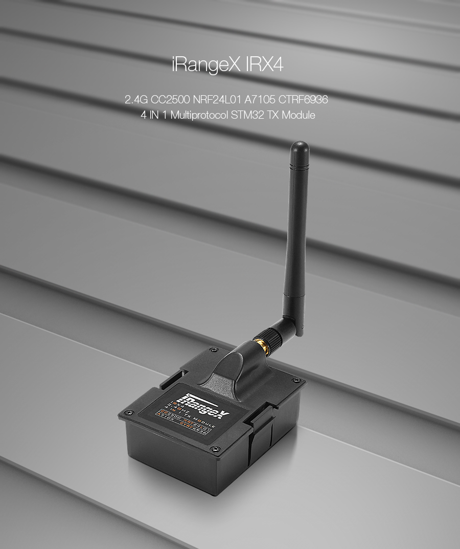

I just received my Devo 12.
I saw in the thread a 4n1 was added.
Is reading about the new IRangeX iRX4 4n1 JR module and how it has more memory now. 128k versus 32k of the previous board due to a new STM32 chip. See below
And read more about it on the Bangood product page here:
Banggood IRangeX iRX4 4n1
I know it's designed for use with the FrSky TX's such as the Taranis and others that use OpenTX but I was curious if anyone has taken it out of its plastic case and tried installing it in a Devo TX?
If it can be...
And if it can, is it more robust memory wise than current 4n1 being installed in Deviation TX's?
I'm new to all this so... I'm curious. And want to know what's what before attempting a hardware mod.
Adding a 4n1 seems more efficient than adding individual chips and additional antennas.
Are there any cons to going with a 4n1 over individual chips etc?

Replied by vlad_vy on topic Anyone successfully added the new iRangeX iRX4?
For Deviation we don't need external module version. You need internal 4in1 designed for Devo Tx. It's direct replacement for original module and it use original Tx antenna. You will need to solder 3 wires only, for selecting additional RF chips.
www.banggood.com/CC2500-NRF24L01-A7105-C...07.html?rmmds=search
