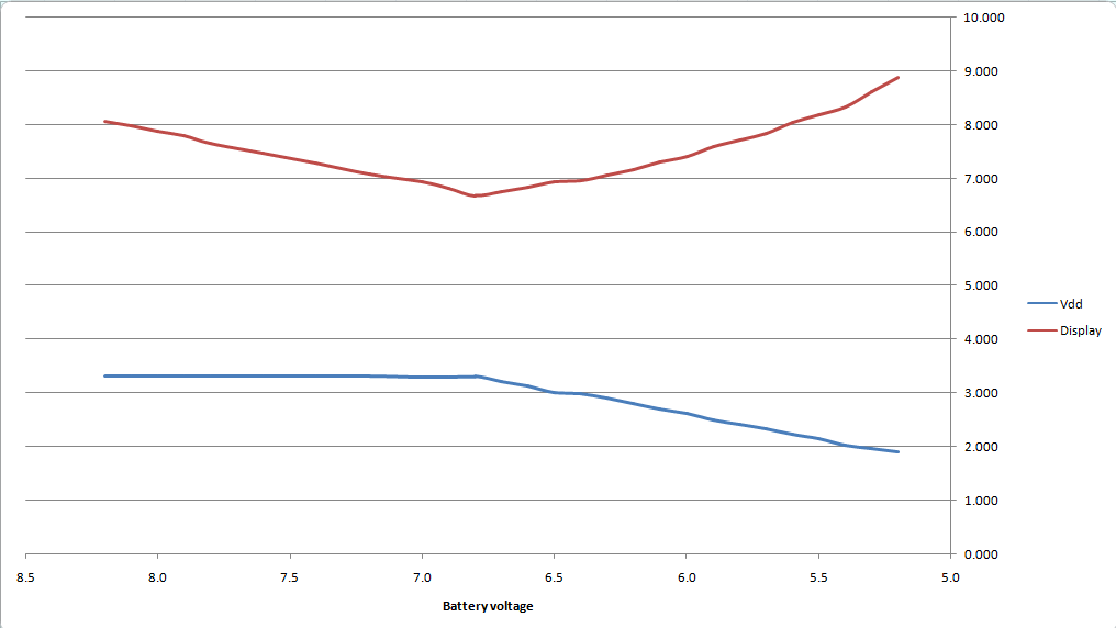

13 Nov 2017 02:37 #65779 by hexfet
Replied by hexfet on topic New TX from Banggood
hexfet wrote: I don't think the reference source is changeable in software for the F103. According to the datasheet in the 64-pin package it is hardwired to Vdd.
Don't see anything obvious looking at the code. I'll test with my tx this week.
Just to confirm what others have said, the battery voltage measurement depends on the CPU Vdd input voltage. The measurement is not accurate when the CPU input voltage is too low. The attached file shows the CPU supply voltage (Vdd) and displayed battery voltage as the battery voltage falls. This is based on measurements from my T8SG.
13 Nov 2017 07:35 #65783 by ramunas
Replied by ramunas on topic New TX from Banggood
@hexfet - Very useful plots! The plots show that the 3.3v supply to the RF chips is dropping 1:1 with any further drop in supply voltage beyond the bend in the curve. I think everyone who realizes this will see the main priority needs to be to fix the hardware to keep the 3.3v supply in regulation throughout the useful battery voltage range. Once this is done the existing s/w will provide an accurate battery reading. I think Jumper knows something needs to be done since some of their first questions were about better low dropout voltage regulators.
