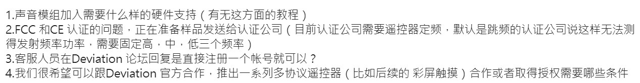

I got reply from T8SG maker , this is their questions,
Translate to English as below,
1, About voice module,where can they get relative information about hardware.
2, They are preparing sample for FCC/CE verification but they got some trouble about frequency setting(I'm not really understand about this question)
3, Is it to register an account for they customer service person then they can reply something? (I will help them to register an Deviation account)
4, They are willing to cooperate with Deviation and produce a serial multiprotocol TX such as color touch screen etc. , how can they get Deviation authorization? what's the detail condition about authorization?

Please post the google translate version of this (or just post/attach the utf text). Might help to figure out item 2.

Hi Hexfet,
Google translate version:
1. What kind of hardware support does the sound module add (with or without this tutorial)
2.FCC and CE certification issues, is preparing samples sent to the certification company (the current certification company needs remote control frequency, the default is the frequency hopping certification company that can not measure the transmission frequency power, the need for fixed high, medium and low Frequency)
3. Customer service in the Deviation Forum reply is a direct account can be registered?
4. We would like to be able to work with Deviation official, launched a series of multi-protocol remote control (such as follow-up color touch) cooperation or authorization required what conditions

Based on past testing with FCC for telecom I've a guess at item 2. For the lab testing they need the radio to have a test mode(s) to transmit at certain frequencies ("high, medium, and low"), possibly with a given power level (max possible, max allowed, etc), for a set duty cycle or other test parameters. For example my company had to provide a test program to stream "U" out all serial ports for FCC emission testing.
Can we get the requirements for the test modes that are needed? The certification company should have guidance on the things the equipment under test needs to do.
