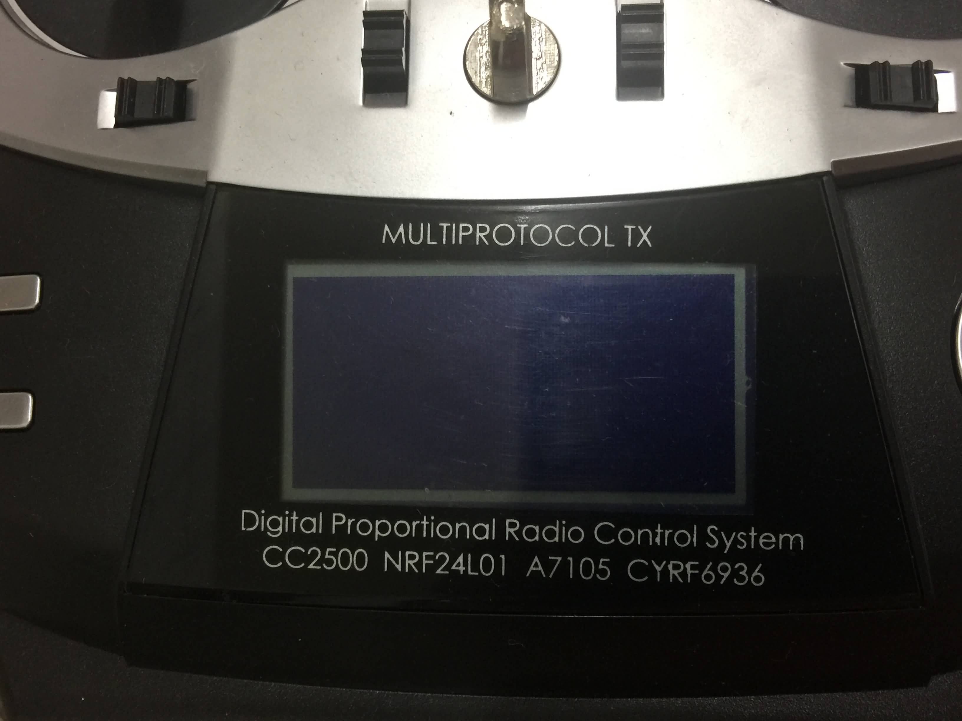

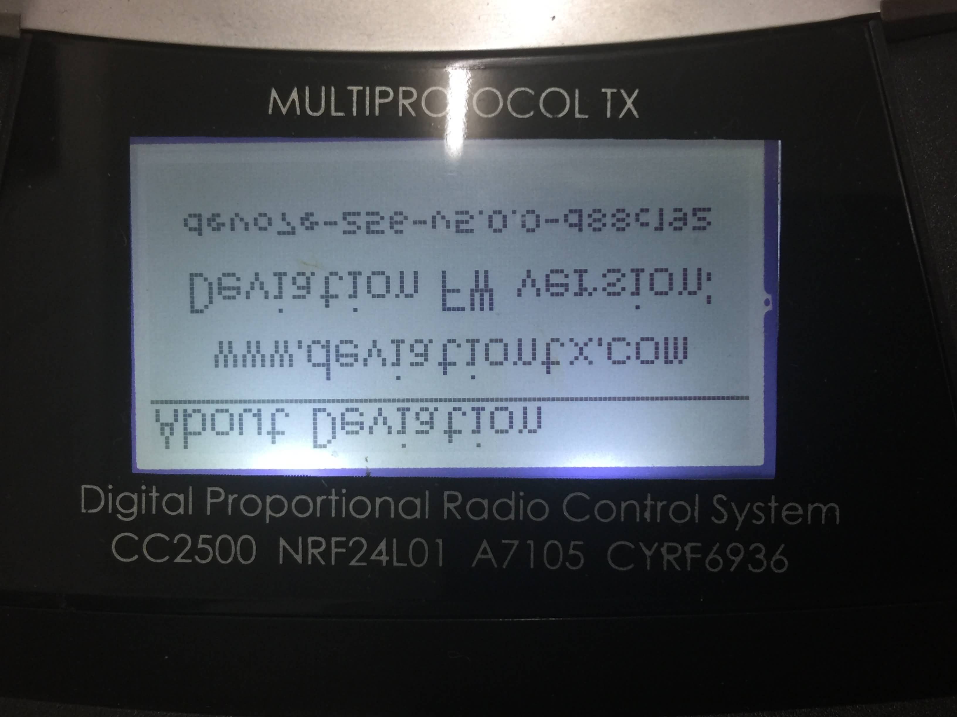

I downloaded NB Sep. 1 and try to update to T8SG with Walkera upgrade tool and got some problem.
1, When I entered upgrade procedure I got all dark screen.
2, It can upgrade FW with Wakera upgrade tool without problem,but after upgrade , I got inverted screen .... :(
I think they use Walkera bootloader , the problem about screen come from different LCD driver.
Is it correct PB?

dc59 wrote: I downloaded NB Sep. 1 and try to update to T8SG with Walkera upgrade tool and got some problem.
Is it correct PB?
Appears so. what is the upgrade procedure for this tx? Does it detect as a '7e' in the walkera uploader?
Do you want me to try to build you a firmware using their driver to get it so your screen is the right way around?
We might recommend that they not use walkera's bootloader, but if they are about to ship, it may be too late. As I mentioned above, it isn't as easy to change last minute.

01 Sep 2017 15:16 #64103 by dc59
vlad_vy wrote: dc59 can you test build with LCD code corrected to T8SG?
Attachment not found
Thanks vlad_vy, but it didn't work, I still got inverted screen ....:(

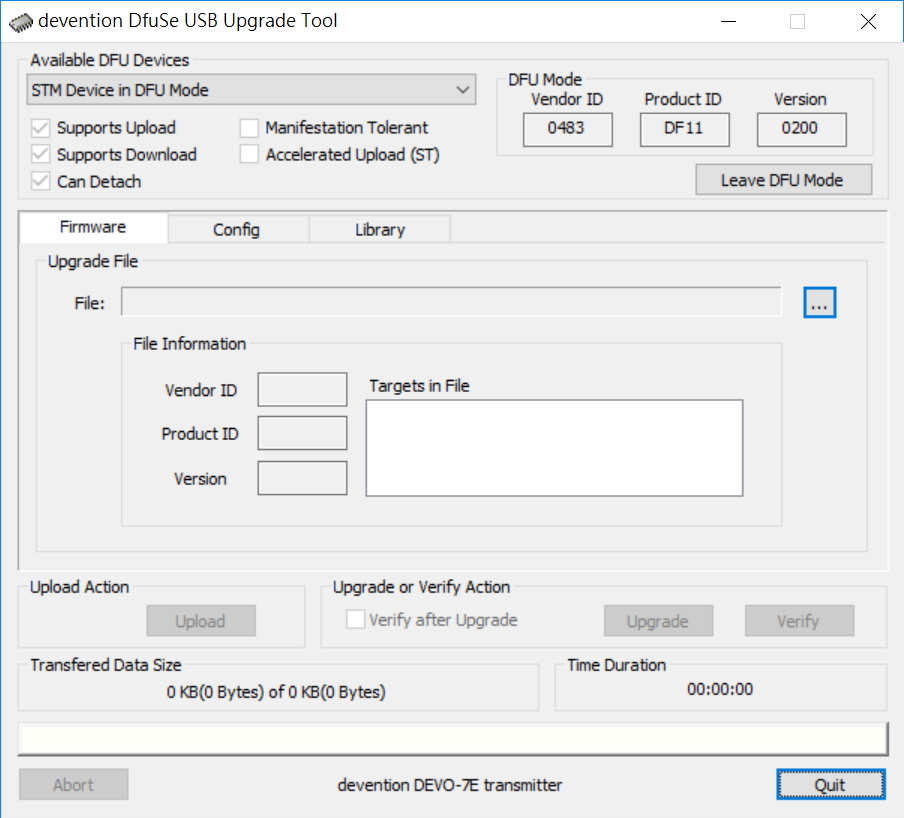

PhracturedBlue wrote: Appears so. what is the upgrade procedure for this tx? Does it detect as a '7e' in the walkera uploader?
I get this screen when I upgrade firmware with walkera tools
Is it detected as 7e by Walkera uploader?
I'll try to contact with them about bootloader change issue.
