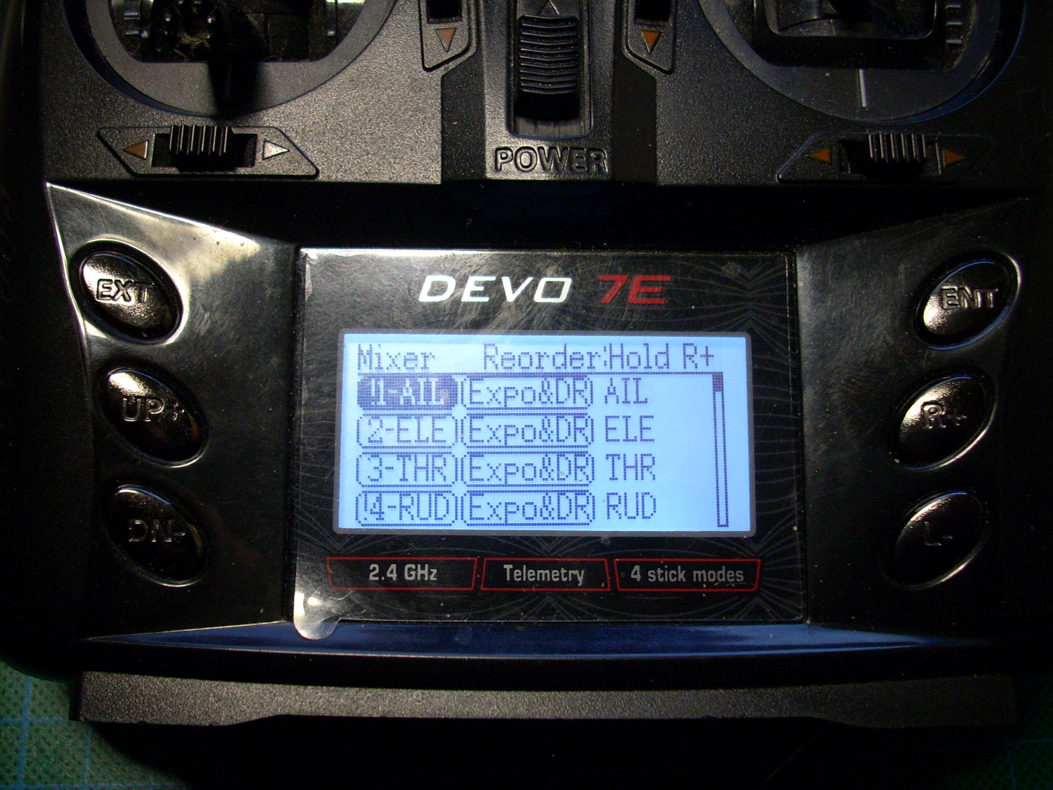

I did try that, and with my model file
Throttle operates Aileron in BF GUI
Rudder is correct
Elevator operates throttle which is reversed
Aileron operates Elevator in the correct direction
I have attached my model file and sorry about the formatting, I do use Notepad++ in the actual TX model file.

Yes, with already modified model config. You can reset model and start from scratch or change sources for channels:
1) src = AIL
2) src = ELE
3) src = THR
4) src = RUD
1) src = AIL
2) src = ELE
3) src = THR
4) src = RUD

Thanks vlad_vy I am trying to do that now in the text editor and sorry about my lack of skills with this
