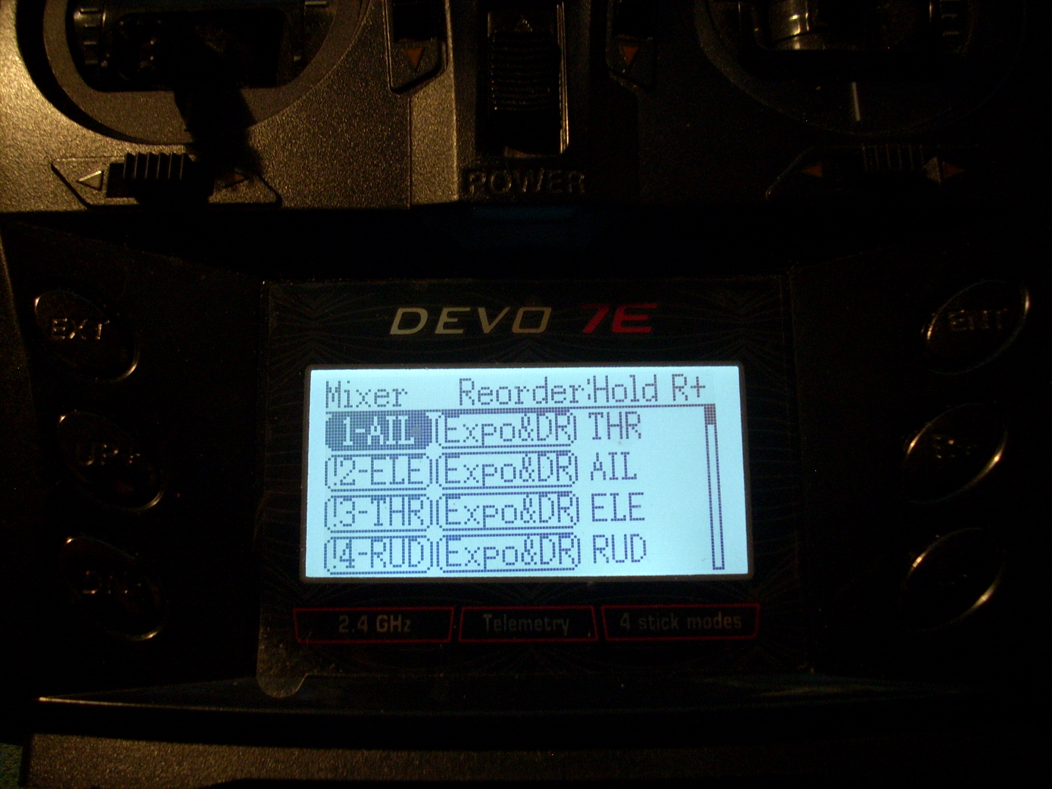

The problem that I am having now is that all channels are operating in the correct direction except Aileron. If I reverse it in the mixer it does not change direction in the BetaFlight GUI and also it changes the direction of the throttle even though I have not touched the throttle setting :sick: . I did have to also reverse the throttle channel but it did reverse the direction in the GUI.
So to summarise all channels are operating in the correct direction except Aileron. If I reverse it then that affects the throttle direction in the GUI.
What am I missing here please?

05 Nov 2017 10:03 #65538 by Wene001
Replied by Wene001 on topic tinyFISH FC - bind to 7E with CC2500
Do you have matching channel order?
05 Nov 2017 10:13 - 05 Nov 2017 10:15 #65540 by Newman
Replied by Newman on topic tinyFISH FC - bind to 7E with CC2500
Wene001 I was wondering about that actually :)
Do you mean how these do not match? I couldn't find out how to change, presumably the left column order?
Sorry I am very weak on setting up TX's
Last edit: 05 Nov 2017 10:15 by Newman.
05 Nov 2017 10:36 #65541 by vlad_vy
Replied by vlad_vy on topic tinyFISH FC - bind to 7E with CC2500
Your flight controller has TAER channels order, you need change it to AETR.
05 Nov 2017 10:39 #65542 by Newman
Thanks but I have no idea how to do that and I cannot find out how to do it sorry.
05 Nov 2017 10:45 - 05 Nov 2017 10:51 #65543 by vlad_vy
Betaflight -> Receiver -> Channel Map = AETR1234 (Frsky/Futaba/Hitec)-> Save
Last edit: 05 Nov 2017 10:51 by vlad_vy.
