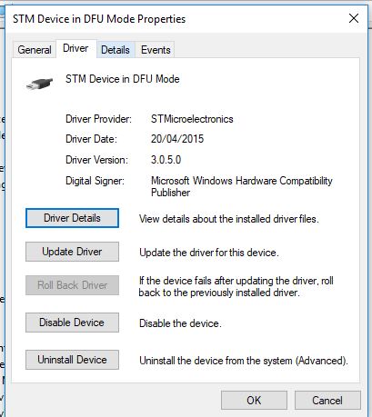

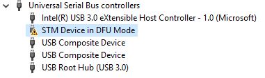

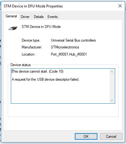

I'm using W10 x64. I tried both Walkera DfuSe driver and Deviation USBDrv Installer. None worked.
Windows recognize the device but give a message: "last usb device you connected to this computer malfunctioned"
I tried also STM drivers and still receive same message. Bellow are device manager screen and driver screen:
*already tried different USB cables and USB ports
There is some thing wrong with Tx or it is a driver issue?

What is strange to me is: the driver is install. As you can see, device manager recognize as "STM device"
So I believe the driver is correct....
Replied by GabrielRB on topic [Report] Windows10 needs driver from STMicro
vlad_vy wrote: Do you run driver install "As Administrator"?
Yes.
