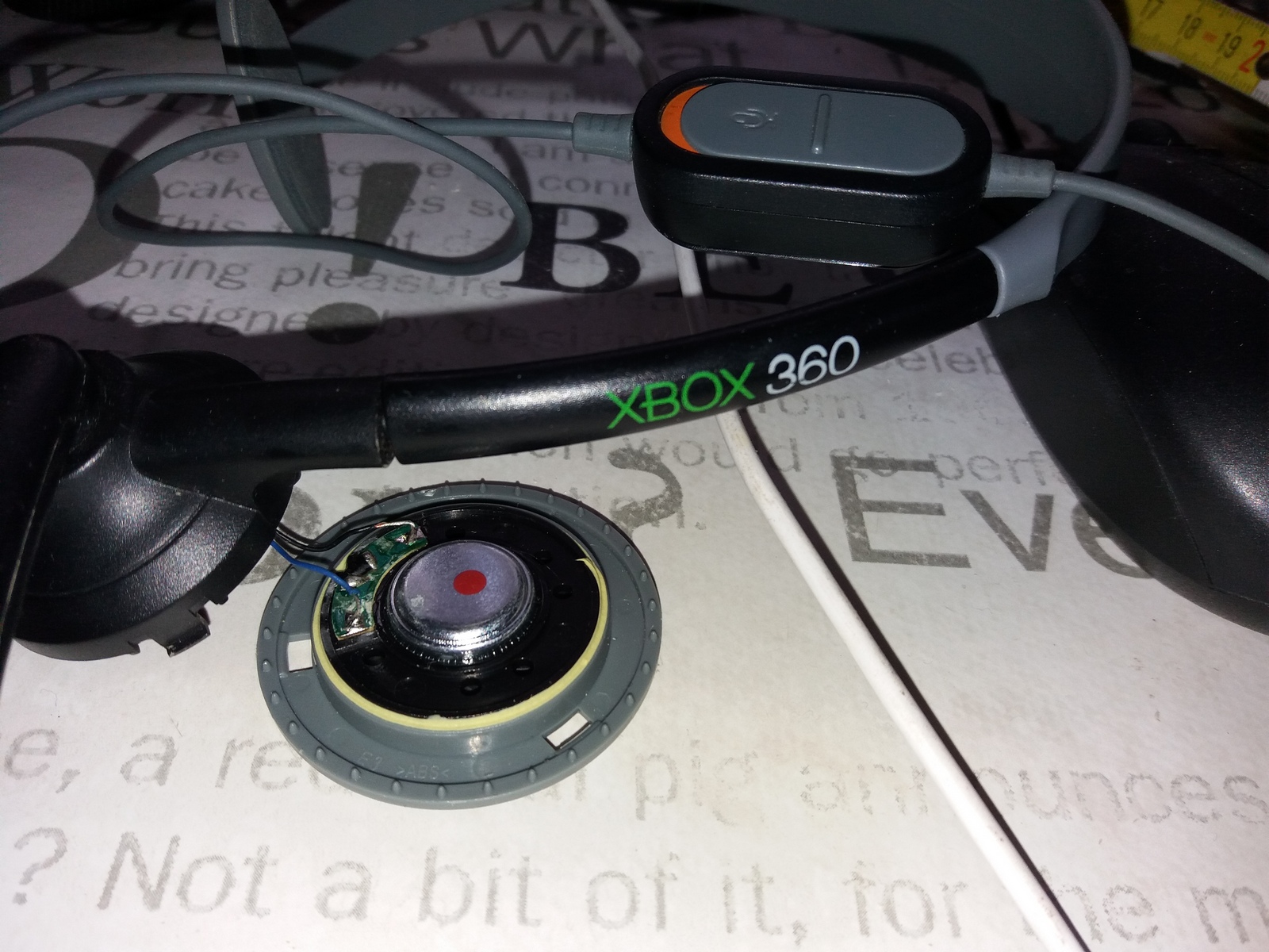

GREAT!
Have to find a speaker - not från CN as we have some issues with deliveries from CN. I have ordered the soundchip from within EU.
I guess i can find a speaker from an old headset. Just sent a couple old ones to the recycling.........
Waiting for shipping information on my TX ordered 1st of june.........................................

22 Jun 2018 16:07 #69687 by pgerts
Replied by pgerts on topic Jumper T8SG V2 plus transmitter
Look what i found in the kids room - has not been used for long ;-)
Worth a try?
