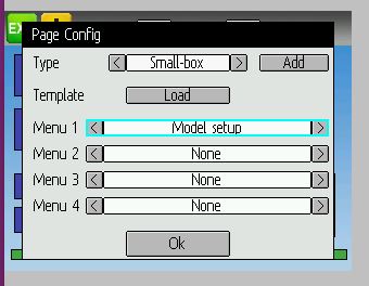

Replied by hexfet on topic Shortcut to ModelMenu
Set up a Quick Menu in the model setup main page config. Choose Model Setup as the target menu. Then on the main page a long press of up/down jumps through the quick menus. This is configured for each model so might be easier to edit the model files.

Hi LeGriffon,
you have to enter model menu, then select "Main page config". Here you klick on the plus icon at the left hand upper corner.
In the menu which now appears in the line which reads e.g. "Menu 2" you change the selection field to "Model menu" by the use of the left and right arrows.
Once you have done that, exit to the main page.
Depending on the line you changed, lets say "Menu 2" like written above, by a long press and release! (about 1 second) of the "L-" button you directly enter the model menu.
From there it is a pretty quick change of models.
Just tested this on my 12S so on your Devo 6 it might be slightly different with "Menu 2" and the button you have to long-press.
Hope this helps!
Best regards
Max

Thanks Max. There's also a Model Setup selection that goes direct to that page. Then Load to select the new model.

The "Model setup" menu which hexfet mentioned is the closest you can get to model select as a shortcut.
In this menu besides of changing model name etc. you can klick on "Load..." which leads you to the model select screen.
I think it would be very possible to add a direct shortcut to this "Load..." menu but this is not implemented in deviation for now.
