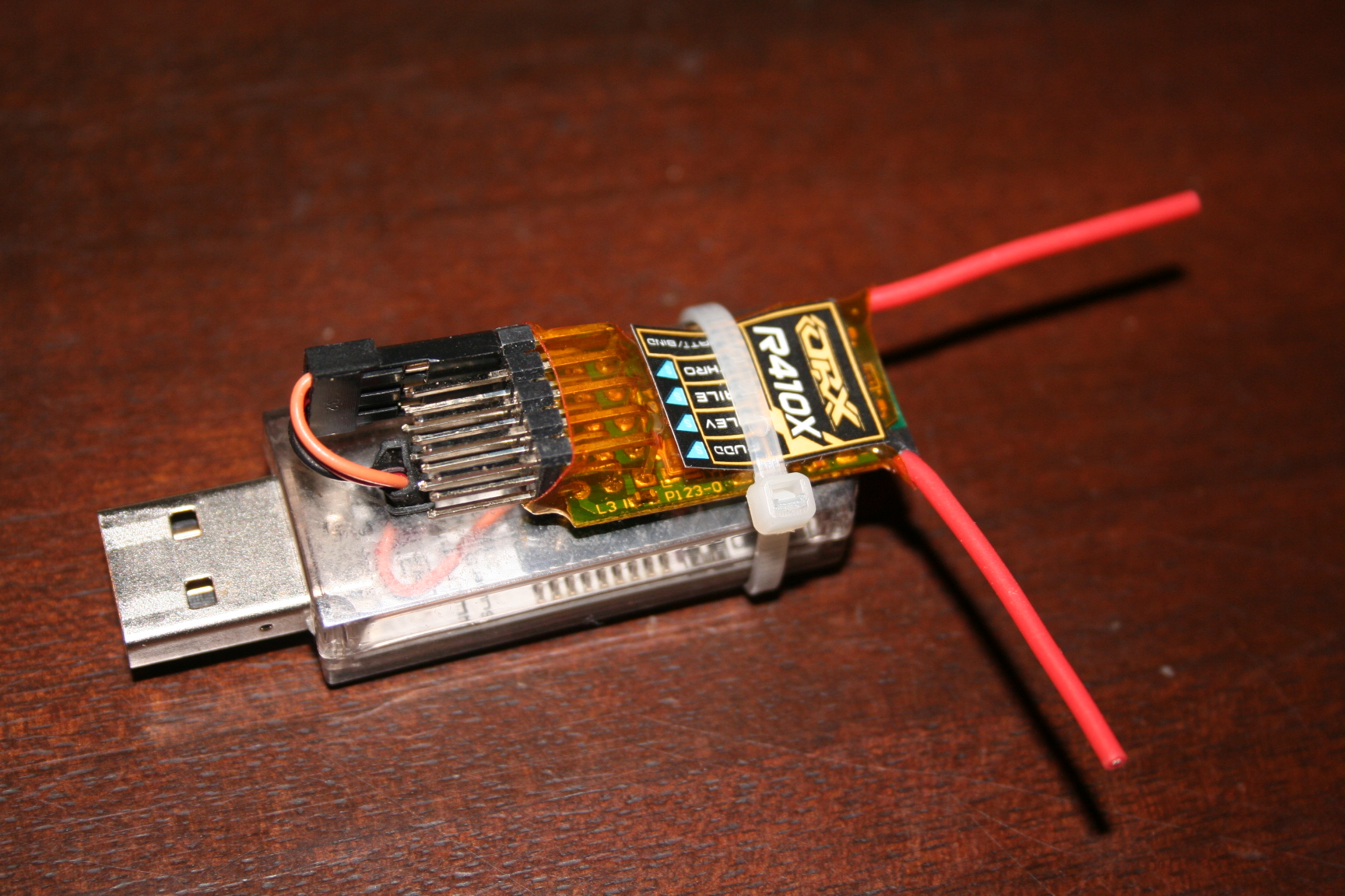

24 Jul 2018 02:29 #69943 by Gerry
Replied by Gerry on topic T8SG Plus with a flight simulator
My flight sims bundle came with a usb adaptor with a cord. I soldered in a servo lead and attach a dsm2 PPM receiver to eliminate the cord. I can still unplug the Rx and use a cord with Taranis.
FFS (Forever Fixing Stuff)
