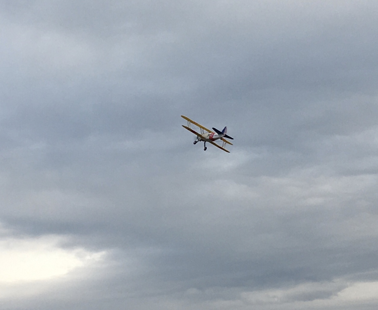

31 Dec 2024 17:51 #78601
by ballbear
Replied by ballbear on topic Flysky Vario Support
The telemetry works, also the max altitude record.
Chapeau dear friend!
Happy and good new year!
Pavel

02 Jan 2025 17:30 #78602
Replied by hexfet on topic Flysky Vario Support
That's a beautiful airplane!

02 Jan 2025 18:42 #78603
by ballbear
Thank you
It is homemade foamie 1,3 m wingspan PT17 Stearman.
The datalog looks good, the over six hundred meters at the end are recorded after disconnecting the battery in the plane after landing.
I am going to organize second altitude sensor for future testing.
The results I will put here ...
Many thanks for your effort
Regards
Pavel
