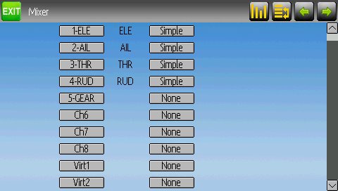

devo 12s with 5.0 frimware . use dsm2 reciver .the ele channel output was alieron and alieron output ele. if conect reciver with seprate channel i can exchange the servo connector but when i use dsm satellite and advanced mode i can't adjust output.
how can i fix the bug?

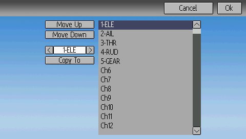

Did you try to change the order of the channels manually? But be careful with throttle. Unscrew the propeller or only use a 2S/300mAh that isn´ t that hazardous. Go to the mixer tab, press the order icon and re-arrange your channels with up/down.

Yes but when I change to advanced mode will lost the setting.
04 Oct 2018 15:42 #71175
Replied by FDR on topic Dsm2 Output channel wrong
No, you won't.
You would lose them in the opposite direction, i.e. when switching from the advanced to the standard GUI...
- cookxk
- Posts: 5
14 Oct 2018 01:24 #71330
by cookxk
Replied by cookxk on topic Dsm2 Output channel wrong
Yes, Change to standard gui the setting will reset, but I want to use standard GUI

This subject has been covered a few times, one of the threads started by myself when I discovered this. Only way is to use Advanced and follow change channel order as already advised. Standard GUI is nice for simple single servo collective pitch heli's but this way forces you to learn to use DeviationTX properly and you will be pleased in the long run that you took the effort.
