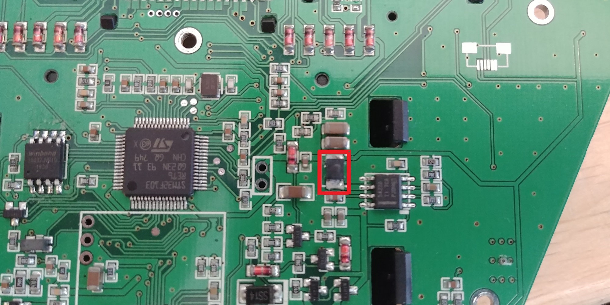

20 Apr 2020 17:54 - 20 Apr 2020 17:56 #76196
by uhtrinity
Replied by uhtrinity on topic Jumper T8SG V2 Plus Will Not Turn On
My personal T8SG and 2 others from my school drone club went down early this year with the same symptoms. Turns out it is a bad / shorted inductor. It's a 10uH smd inductor. There are a few on the board, one appears to power the LCD screen and the otehr the CPU and transmitter. The ones powering the CPU and transmitter were shorted and showing less than 1. A healthy one should be around 2 ohms. Hope this helps assuming it's the same issue.
Last edit: 20 Apr 2020 17:56 by uhtrinity.
