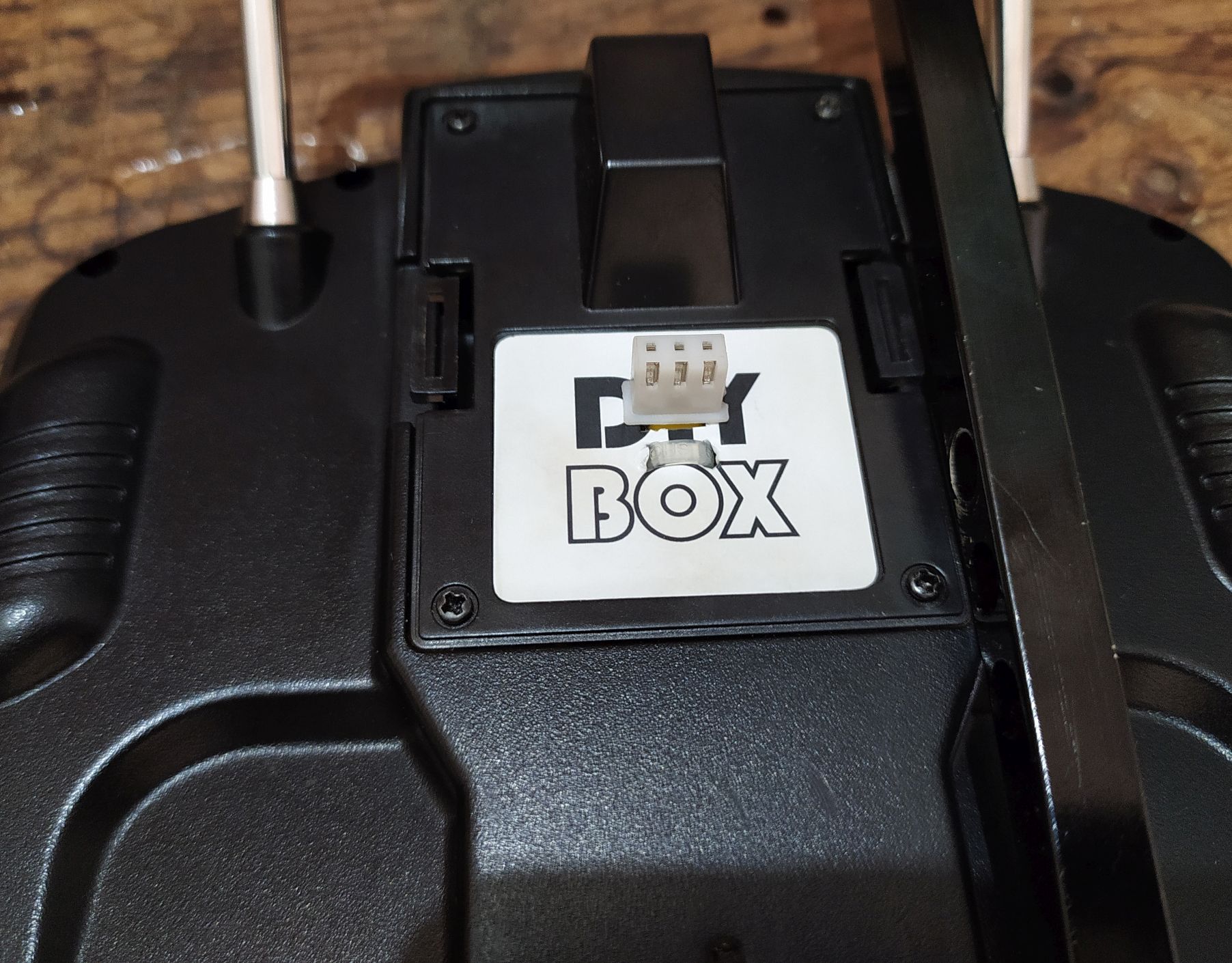

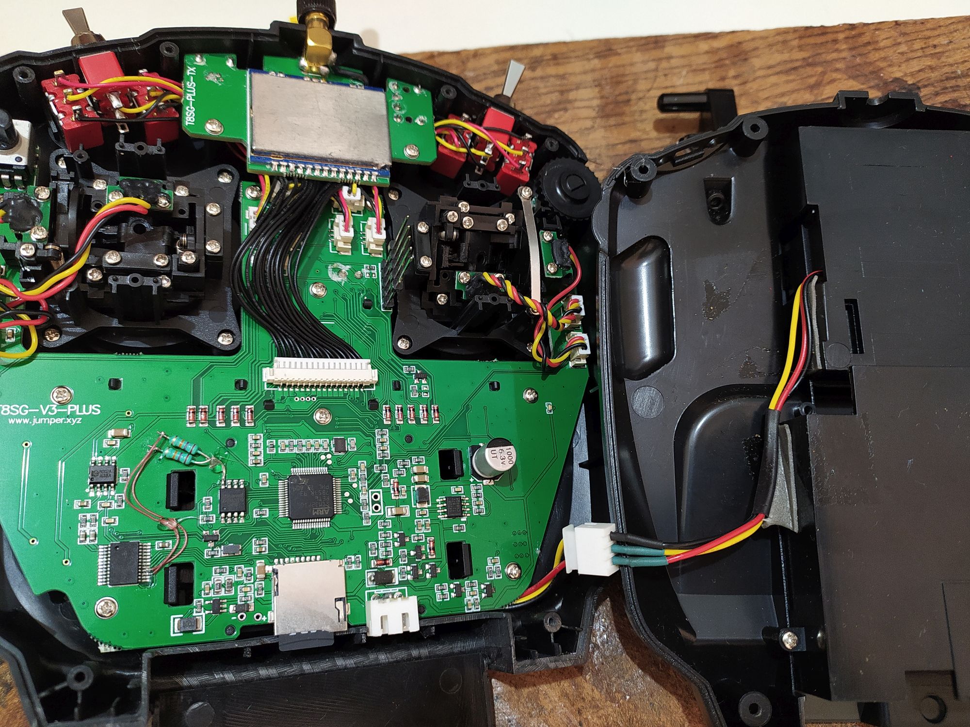

All your replies got me looking in the correct direction. I had actually made an external charging mod where I ran the balance connector out so I could charge the LiIon batteries without having to pull them out. This cable was routed quite close to the throttle/rudder gimbal and I suspect this was the issue. Photos below.
But it's strange that the hall sensor / wriring was being affected even when there was no current flowing in the balance cable since the battery was not being charged.I have removed the cable and now the rudder seems fine. I'll observe it for a few more days to be sure as the rudder sometimes used to work fine earlier. If this really is the issue then I'll have to find another place to mount the balance connector.

After having used the TX for some flying sessions I can say that the rudder stick issue is mostly resolved but I do rearely see that the values don't change proportionate to the throw. I will open it up again to see if there are any other wiring issues. I did twist the rudder gimbal cable to reduce interference but may be that wasn't a good idea as rest of the cables are not twisted. I will put it back as it was and see if the problem goes away for good.

My thoughts....the T8SG and T12 products are not of good wiring connector quality from the gimbal to the main board. It is. Poor connector contact occurs regularly, making the operation unstable. The gimbal signal is a very small current signal, so it's a story that sometimes happens in other companies' transmitters as well.
I plan on doing away with the connectors and soldering them in the future.

I guess you are right. By twisting the cable may be all I did was add more strain on the connectors.
