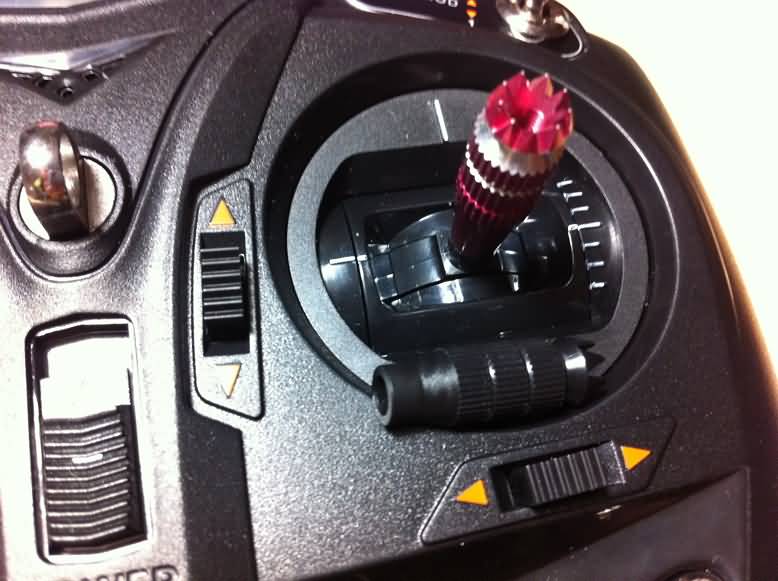

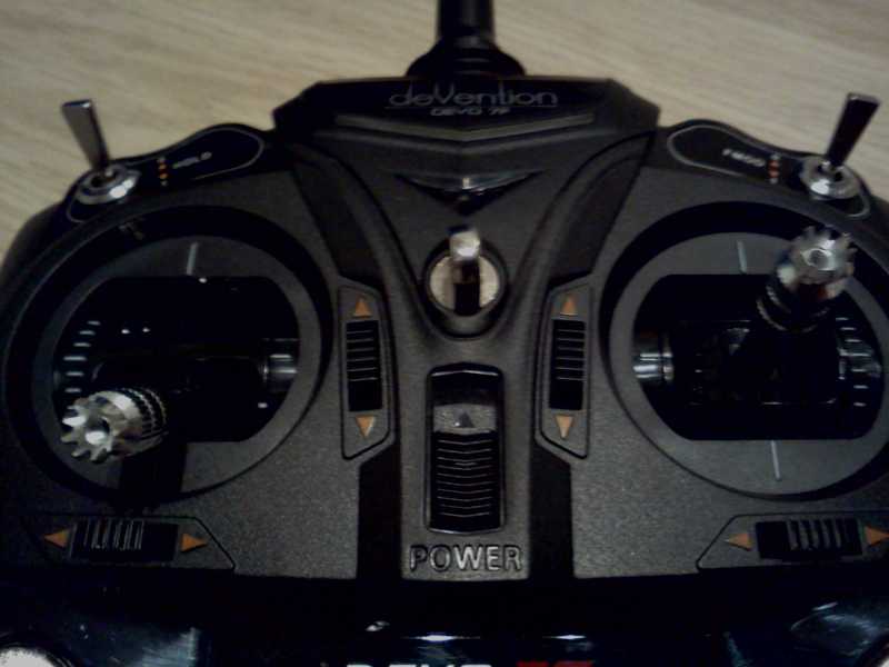

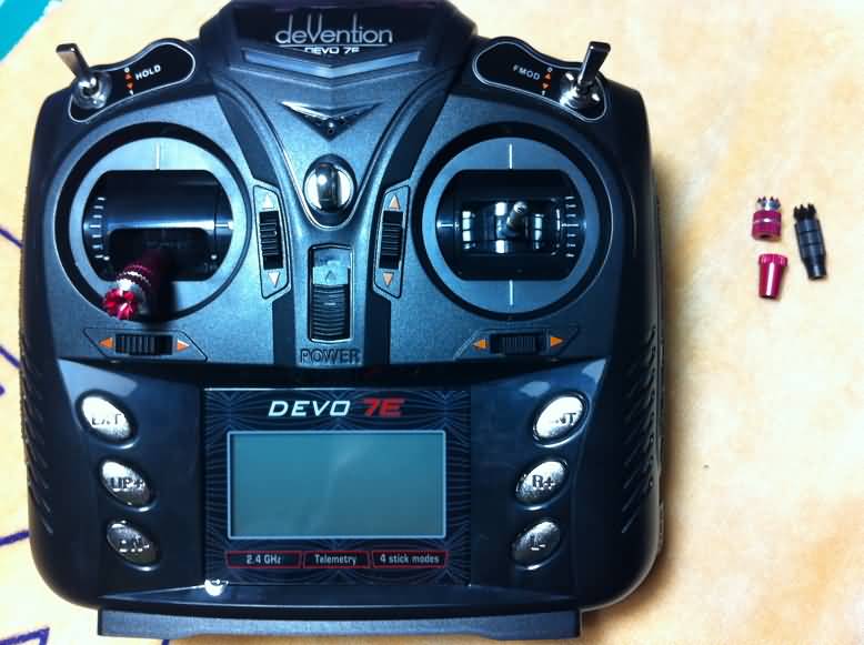

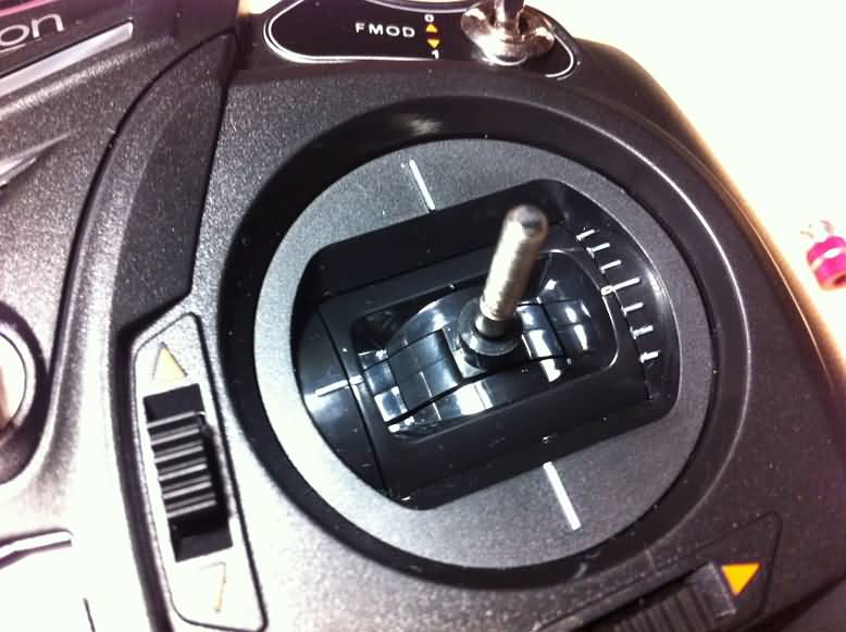

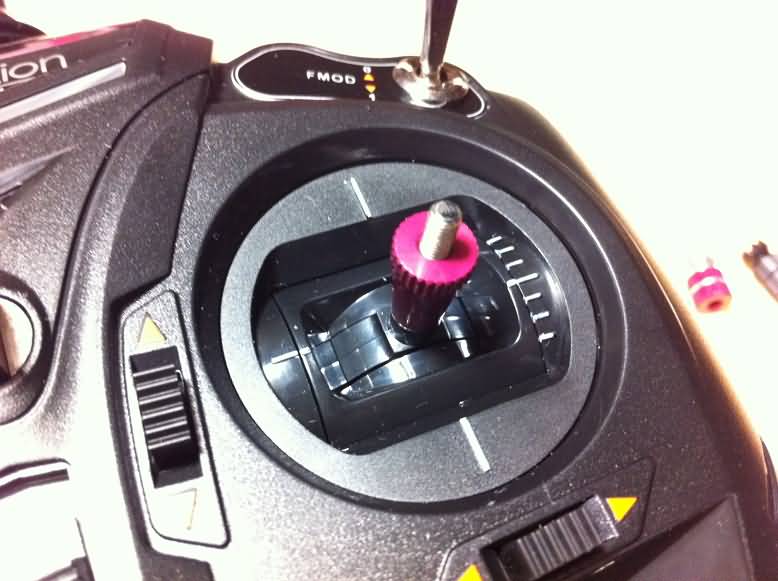

"Are the plastic sticks unscrewable, ie. can they be replaced with metal ones? Not that that's a deal breaker."
Yes, you can find a Futaba stick(M3 size) to replace the plastic one.

16 Jan 2013 01:50 #5050 by dc59
Replied by dc59 on topic Devo7e work
I didn't unscrew it from inside of TX,
I just changed the stick top knobs only ............ :S
16 Jan 2013 14:07 #5063 by PhracturedBlue
Replied by PhracturedBlue on topic Devo7e work
How did you change the knobs on the 7e? Mine appear to be molded down to the stick. With enough force, you can get the sticks to start turning, but it wasn't clear to me that they were actually unscrewing when I did. I don't feel like breaking my 7e at the moment, so I went no further.

17 Jan 2013 06:35 #5096 by dc59
PhracturedBlue wrote: How did you change the knobs on the 7e? Mine appear to be molded down to the stick. With enough force, you can get the sticks to start turning, but it wasn't clear to me that they were actually unscrewing when I did. I don't feel like breaking my 7e at the moment, so I went no further.
As usual, nothing is as easy as it seems. getting the modular protocol code working properly was a lot more work than I expected. I probably spent a whole day just on the build system. The modules themselves also caused me no end of pain. However, I think I've finally got everything working now. I need to go try to fly a bit I guess.
Just like this.
