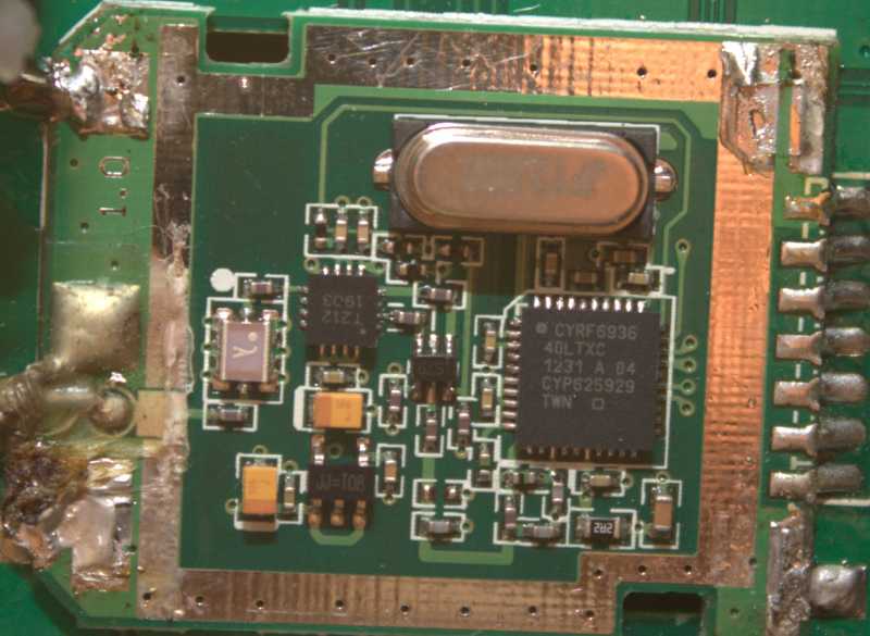

21 Jan 2013 16:20 #5325
Replied by PhracturedBlue on topic Devo7e work
FYI, here is an image of the module with the shield removed. the diode in question is just below the xtal
- Xermalk
- Posts: 181
21 Jan 2013 16:26 - 21 Jan 2013 16:27 #5326
by Xermalk
Replied by Xermalk on topic Devo7e work
So, theoretically one could make this a >10mW Tx if one could remove the metal cover and add a small drop of solder over the entire diode? (Easier but not as good as soldering a wire over it)
Last edit: 21 Jan 2013 16:27 by Xermalk.
21 Jan 2013 17:09 #5327
Probably yes. That picture is deceiving though. Those are really small parts. I probably wouldn't want to do anything without magnification. Also, getting the shield off was more work than I expected armed with my 150W gun and a solder-sucker and solder-wick, I still had trouble cleaning the pads enough to get the cover off. My gun is old and was being quite finicky, so that may be part of it.
I'm planning to take the diode off and replace with a shunt to see what happens, but no need to do that right at the moment.
Also note that there are all sorts of impedance matching issues to take into account. It is actually possible that shorting the diode will actually make reception worse. I'm assuming that won't be an issue though, since they use the same antenna for Rx
