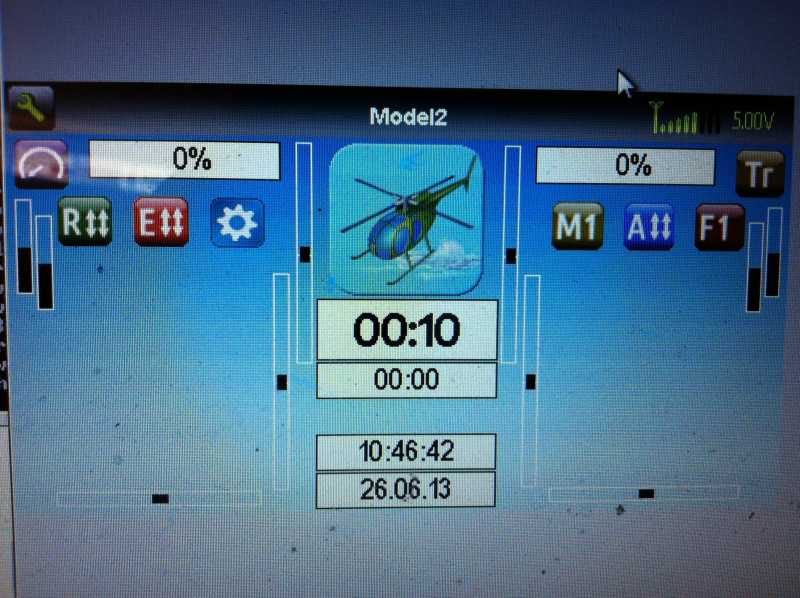

This is what i want to submit for a template. It is very basic but is setup to show all the important info for a regular heli.
I used big boxes to display the info for guys/girls with "older eyes" and makes things easy to see at a quick glance.
Toggle icons are layed out in the position they are on the transmitter (12s), and only show when switch is activated. The two boxes at the top can represent knob value, or in this case they display the main blade pitch % and gyro gain %. You can use the upper trims to fine tune your hover pitch or tail gyro gain in flight.
The mix switch is used to select between three different gyro gain values. (Mix2 is set below 0% to switch gyro into rate mode where you can check/set the tail blade pitch.
Flight mode switch is also displayed next to throttle % box. It displays throttle amounts with a 0% - 100% scale. Hold switch will show 0%.
5 bargraphs for whatever channels you need displayed. I might use these to show the side dial positions.
Top timer on the right shows the countdown timer. It is triggered with the hold0 and reset with trn1. The stopwatch is below it and is also started when hold is off. I find this setup useful when using the simulator. The countdown timer keeps things real and reminds me its time to land, and the stopwatch shows how much total time i've wasted sitting in front of the computer.
In this layout the clock is in a big box for older eyes, but in my advanced layout i will need that space. I also dont see the need for a date box, but... why not.
ISSUES:
24hr clock
The clock did drop a min while i was setting up, and gained 4 hours at some point as well. It might just be an EMU thing when its shutdown.
After exit and save when i had finnished all the mixing info, the emu stoped responding and had to force quit. Thankfully the mix info did not get lost.
Pics below.

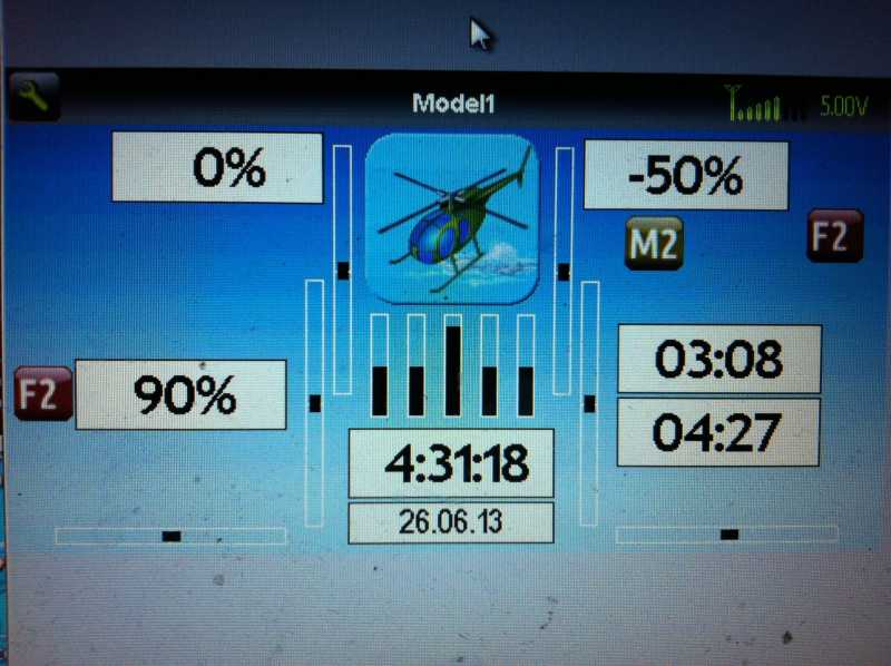

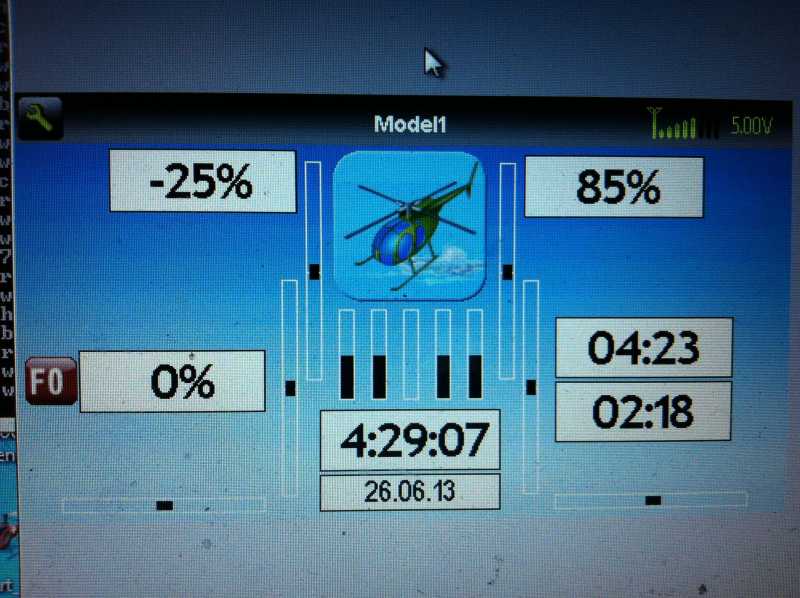

26 Jun 2013 09:20 #11390 by Kdean
Replied by Kdean on topic PB's newgui
Another pic.
26 Jun 2013 09:22 #11391 by Kdean
Last one.

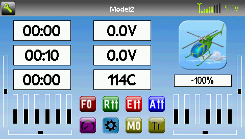

26 Jun 2013 10:33 - 28 Jun 2013 09:39 #11395 by vlad_vy
Replied by vlad_vy on topic PB's newgui
vlad_vy wrote:
vlad_vy wrote: Without any specific idea, to fill screen only.
File Attachment:
File Name: model1_2013-06-25.ini
File Size:1 KB
File Attachment:
File Name: model2_2013-06-25.ini
File Size:2 KB
The same layouts as templates for Devo 12
File Attachment:
File Name: Devo12-6.ini
File Size:1 KB
File Attachment:
File Name: Devo12-4.ini
File Size:1 KB

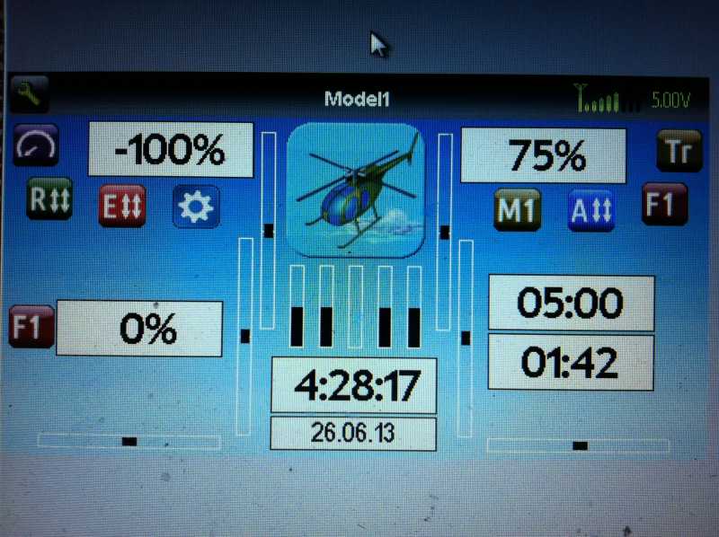

26 Jun 2013 10:52 #11396 by Kdean
This advanced layout is for devo12 only. Showing all toggles and dial inputs with bargraphs.
Leaving alot of space for boxes on either side.

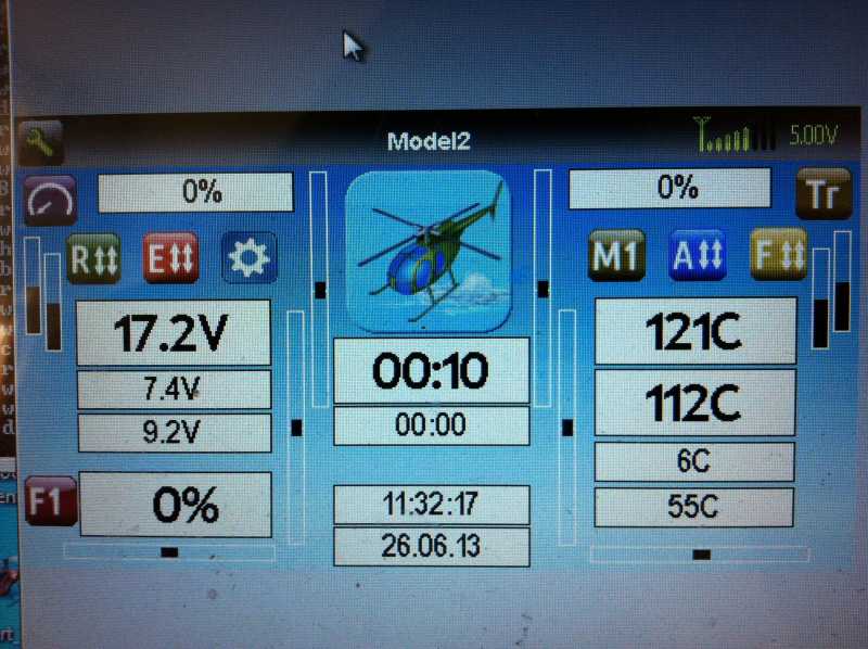

26 Jun 2013 11:40 #11399 by Kdean
Here is my full blown gui layout with telemetry.
