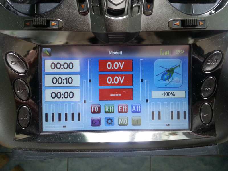

Put the latest build on (9db3fe).
Screen is about 20 pixels to the right and 10 pixels down.
Blue line across the top, and the screen wraps around on the left.

27 Jun 2013 05:21 #11443
Replied by rbe2012 on topic PB's newgui
I will have time in the late afternoon (10h from now) to install on both Devo8 and Devo12. Actually I see no reason for the shift Hexperience has seen.
I'll keep you informed (but others might be faster

I have the same thing.
Replied by vlad_vy on topic PB's newgui
Hexperience wrote: Put the latest build on (9db3fe).
27 Jun 2013 12:56 - 27 Jun 2013 13:48 #11449
Last edit: 27 Jun 2013 13:48 by vlad_vy.
27 Jun 2013 13:08 #11450
This is a leftover from the initially centered 320x240-screen on the wide display.
