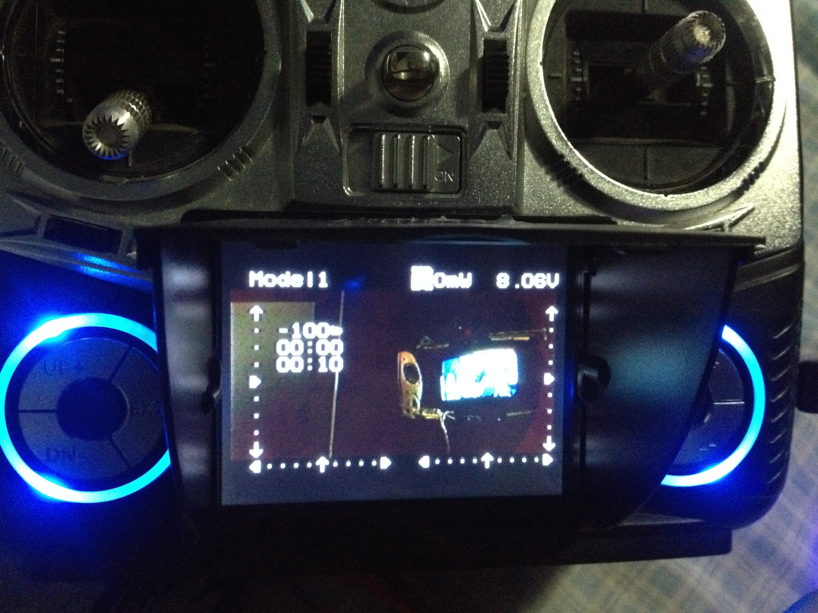

27 May 2015 20:46 #33076
by djtrance
Replied by djtrance on topic Can Any help me with my F7
PB,
Now I have the video tx working, Is basically a copy of the F12E function with the gpio of the devo F7. The channels are only 8, I must change the numbers for F7 because the initial channel on f12E is 0 and into the F7 is 1. I will upload the code tonight I guess.
Maybe in the future we can do a spi driver for the video rx, because with some little modification, we can use all of band in this video Rx, but is required a modification on the video board.
I have know some code to the graphics of the mix curve function, I'm not ready to release it, obviously will not have the same quality like devo10 but we can see something similar.

28 May 2015 03:57 #33096
Replied by PhracturedBlue on topic Can Any help me with my F7
Nice. I merged all this into the trunk. you don't need to continue working on the 'devof7' branch anymore.
