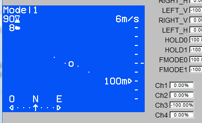

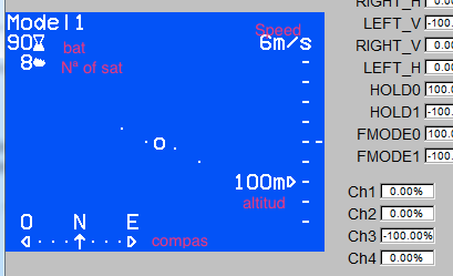

PB, this is my HUD concept. is only a test is not functional. This can be better on f12E. Can be a good idea to do this on devo radios?. maybe there are not a telemetry system yet, with all of the information that we need do use it with devo (mavlink has all information but is use it on other type of transmitter). I have a NRF system with telemetry, maybe in the future we can do a new protocol for this purpose.
in the second picture you can see the description.
04 May 2015 13:44 #32060
Replied by PhracturedBlue on topic Can Any help me with my F7
It looks good. It will take a little modification, but once I've enabled the proper main_page controls, it should be possible to setup a HUD layout like this pretty easily. Currently there is no compass, and altitude can't be assigned to a trim, but the concept is sound.
