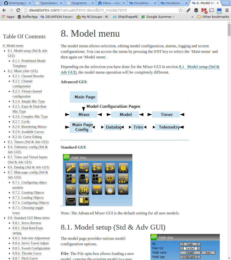

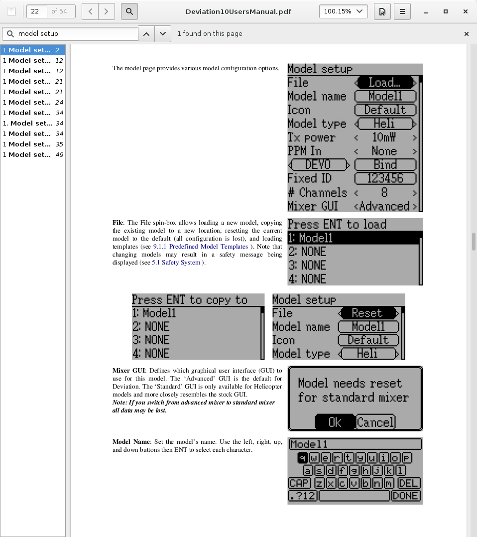

28 Jun 2015 16:22 - 28 Jun 2015 16:23 #34790 by mwm
PhracturedBlue wrote:
mwm wrote: Model menu cycle up/down arrows seem to be misplaced
Could this be a browser issue? That is an svg image. It looks fiune to me in Chrome/Chromium
Perhaps a screenshot
I'm using Chrome/Chromium. I've attached the screenshot. Note that the arrows on the left and right side are just wrong.
mwm wrote: Model setup on the Devo10 seems wrong.
The html manual has several formatting issues I need to look at eventually. Is it just formatting, or is there some other visual issue?
This is not just an HTML I've attached a screenshot of the PDF version. Note that the "Copy to" and and "Reset" Image aren't left-aligned like the rest. The HTML version is slightly different, but still not left-aligned. Possibly this is intentional.

28 Jun 2015 17:58 #34795 by PhracturedBlue
Replied by PhracturedBlue on topic Is a Deviation v4.1 release on the near horizon?
images look (almost) ok to me.
The problem with the arrows is that for some reason you can't see the lines between them. Compare to the 4.0.1 manual to see how it should look.
28 Jun 2015 18:07 #34797 by mwm
The arrows look right in the PDF version of that manual. This is strictly an HTML problem.
The images look right to me. Just a minor layout issue. Like I said, maybe that's the way you want it.
