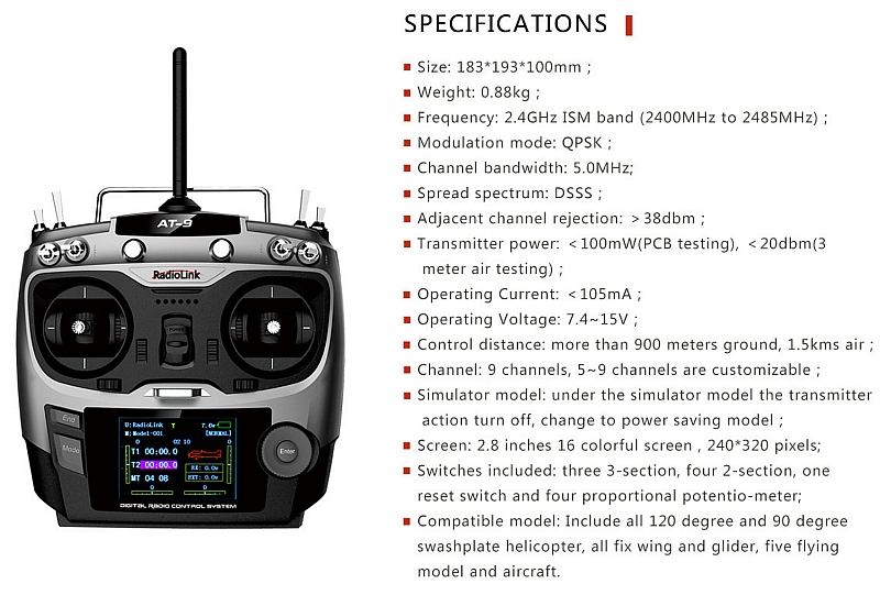

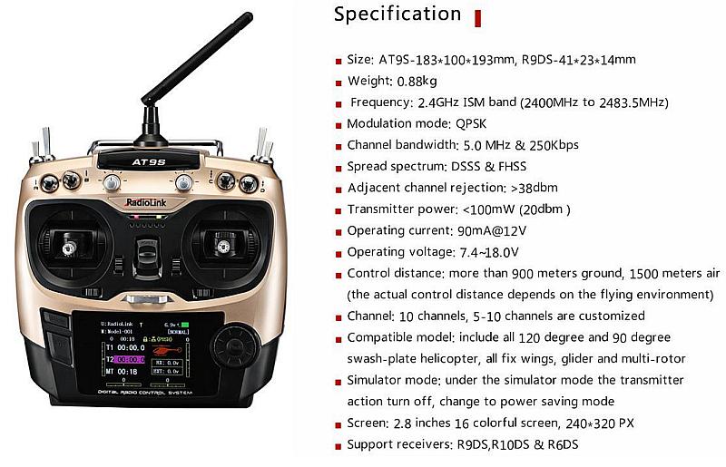

- bianchifan
- Posts: 49
10 Jul 2016 09:22 - 10 Jul 2016 09:42 #51513
by bianchifan

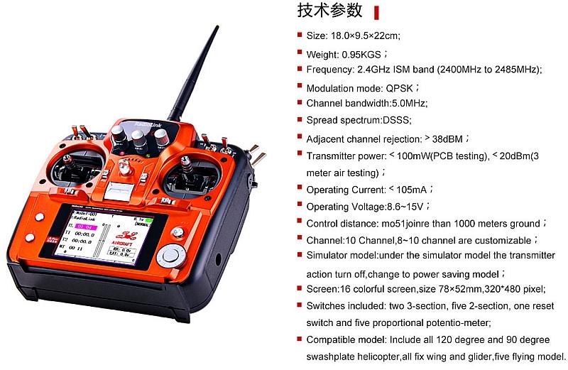

And yes, if you like to strip the radio it may not interest.
But please tell me, why I should do so?
When I asked TI some time ago I was recommended to go for CC2530 over CC2500.
At this moment I'm still in an evaltuating process but I tend to forget FRSKY and swap over to CC2530.
Since when?
Replied by bianchifan on topic Radiolink AT9 as a platform for Deviation?
I answered due to the diffs seeable at their webside, nothing more.victzh wrote: And it is almost immaterial for the purpose of using it as a new platform for Deviation. For standard Deviation use pattern we're replacing the radio part with our own radio module and it becomes just another (well-specced - powerful processor, large number of switches and pots) Deviated TX.
Another use - Deviation on unmodded AT9 supporting native Radiolink protocol - is not there yet. For this use differences in radios may be in radio module, not in the TX itself.
???anasm2010 wrote: The AT9 have also 10 channel
Since when?
Last edit: 10 Jul 2016 09:42 by bianchifan. Reason: pics added
- anasm2010
- Posts: 22
11 Jul 2016 10:51 #51546
by anasm2010
Replied by anasm2010 on topic Radiolink AT9 as a platform for Deviation?
@bianchifan , I get mine on the beginning of 2016 and It has 10 channel when used on Sbus! you can see the 10 channel at the 13 min of this video --->
