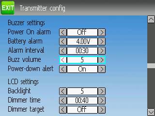

20 May 2016 20:50 - 23 May 2016 04:44 #48897
I found a small glitch in the scrollable form.
The "Transmitter menu", which in default needs no scrollbar to show all the items will unexpectedly show the scrollbar if I step through the buttons to the last from top down, but it doesn't happen if I step through upwards.
EDIT: The model menu behaves the same...
FIXED in ec6456a...
Replied by FDR on topic Test of the new menu system
FIXED in ec6456a...
Last edit: 23 May 2016 04:44 by FDR.
20 May 2016 20:57 - 23 May 2016 04:45 #48900
Last edit: 23 May 2016 04:45 by FDR.
