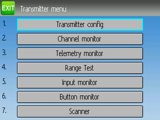

I've started to work on the new menu system to better its look on the color screens.
This is how it looks now:

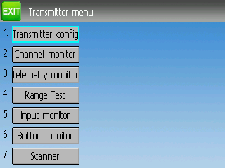

It is much better if I enlarge and center the button:

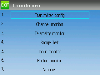

But I think we should get rid of the button face all together:
It is the same button, just the bitmap of it is fully transparent.
I would be happy if I could left align the text, like it is on the B&W screens, but the button widget doesn't allow that.
What do you think, which looks better?

23 Jan 2017 22:24 #58332 by Moeder
Replied by Moeder on topic Test of the new menu system
I like the larger buttons without the "old school" button face. What about getting rid of the left-aligned menu numbers? To me they look odd and useless, since we don't have to scroll like on devo/7e/10/12e. If going without button face, I'd choose a different color for the menu selection, cyan is not made for me ;)
24 Jan 2017 03:59 #58336 by Deal57
Replied by Deal57 on topic Test of the new menu system
Agree with Moeder, big buttons, transparent.
For me i don't really focus on the look/feel of the color menus now that they can be (mostly) used with the buttons like the mono menus. But when I use the stylus or my fat fingers, I find the larger targets (buttons) work better for me.
