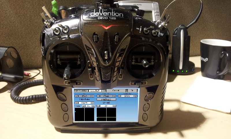

There are still some display issues (some fonts aren't showing properly), and for some reason the analog update isn't working, so i can't actually read channel values, but I think everything else is functional now.
Just as a reminder, we're going to start with the Devo8 interface, which means 320x240 which is why it is running in a window. eventually we'll do a custom 480x272 interface, but for now this will get the functionality out there much more quickly.

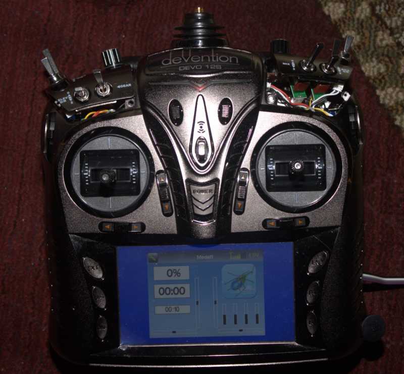

I assume that is a color printed label? Can you post the image file you used?
Or anyone that has a good high res version of the logo?
Replied by Hexperience on topic Devo 12
Wene001 wrote: Ready Steady Go
