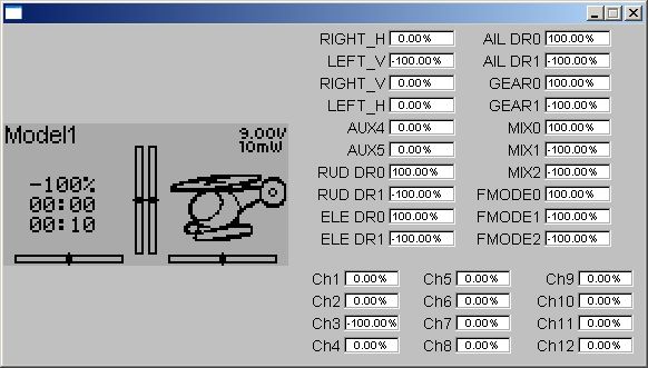

09 Jan 2018 10:43 - 09 Jan 2018 10:54 #66782 by vlad_vy
Replied by vlad_vy on topic Deviation v5.0.0 build with latest protocols
I havn't idea. Nothing changed about switches. What you see at Channel monitor screen?
What firmware do you use previously? v5.0.0 builds or Nightly builds?

09 Jan 2018 11:31 #66783 by jpnews
Before I used the firmware version deviation-t8sg-v5.0.0-4810939 of 18/12/2017 and I did not have this problem. All my switches are in AUX4 AUX3 - AUX2 - AUX1 etc ....
09 Jan 2018 11:38 #66784 by vlad_vy
Probably it related to mixed filesystems, if you don't replaced Nightly Build filesystem to v5.0.0 filesystem.
If you like to use "v5.0.0 build with latest protocols", you need change filesystem. Otherwise you need flash latest Nightly build.
