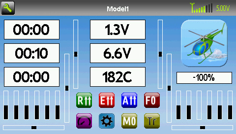

For fullscreen Devo 12. First attempt to create custom layout templates.
File Attachment:
File Name: Devo12-6_2...6-28.ini
File Size:1 KB
File Attachment:
File Name: Devo12-4_2...6-28.ini

I'm not sure that 4/6 channels display will be the best solution. It's much easy to reassign objects or delete unneeded objects, than to add and place additional objects. Possible will be the best to hide(None) unneeded objects at default layout template, it allows to reuse object when it required.

Minor change. The order of toggles now fully corresponds to phisical placement of real switches. First row - short switches, second row - long switches.
File Attachment:
File Name: Devo12-6_2...7-01.ini
File Size:1 KB
File Attachment:
File Name: Devo12-4_2...7-01.ini
File Size:1 KB
