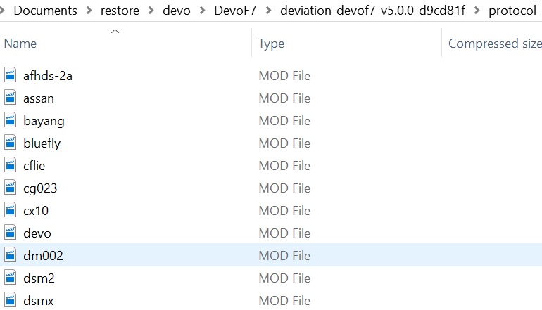

- Cyberkul11
03 Sep 2017 18:49 #64150
by Cyberkul11
Replied by Cyberkul11 on topic How to load an F12E with Deviation(Possibly F7)
Same Problem with 9c46f3b Build - No DSM2 and DEVO Bind`s.
DSMX Works.
DSMX Works.

by RubenRC
DEVO F12E | Devo F7
Replied by RubenRC on topic How to load an F12E with Deviation(Possibly F7)
you guys will need to pull those protocols from the build zip and then add it to the devo.fs file using the build.exe command. attached is a screenshot of the protocols you need to extract then now to the folder you use to create the devo.fs file you will need to copy to the F7 when you have it in usb mode.
