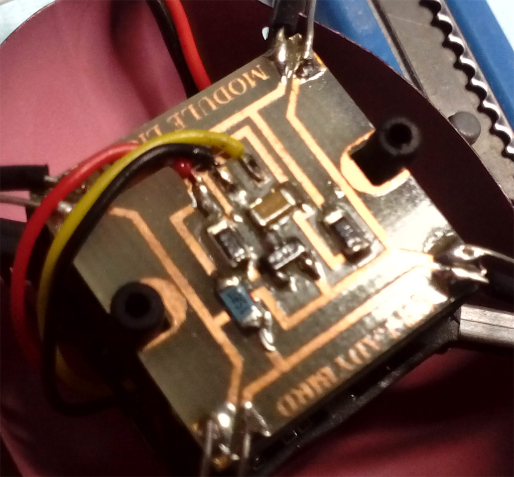

- Franck
- Posts: 87
27 Apr 2015 19:32 #31718
by Franck
Replied by Franck on topic Ladybird V1 (Led on Aux ?)
Here is a picture with the components. I can not take the values with the multimeter, because of the varnish. But you can rely on numbers. cordially
nsm08.casimages.com/img/2015/04/27/15042...4415420713212636.jpg
- ursus69
- Posts: 143
28 Apr 2015 18:17 #31745
by ursus69
Replied by ursus69 on topic Ladybird V1 (Led on Aux ?)
Hi Franck!
Thanks for the picture! I'm very bad with electronic
What is the brown component??
The list will be:
- 470 resistor
- 390 resistor
- 15R0 ¿resistor?
- ¿2G? ¿transistor? ¿NPN?¿PNP?
- ¿Brown component?
Thanks for all!
And sorry for the inconvenience
The list will be:
- 470 resistor
- 390 resistor
- 15R0 ¿resistor?
- ¿Brown component?
Thanks for all!
- Franck
- Posts: 87
16 May 2015 20:27 #32659
by Franck
15RO - 15 ohms
470 - 470 ohms
390 - 390 ohms
2G - Transistor PNP
470 - 470 ohms
390 - 390 ohms
2G - Transistor PNP
