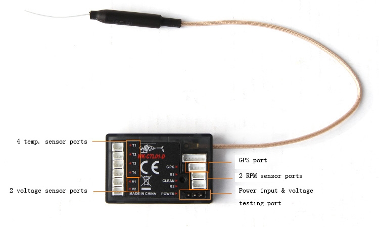

11 Mar 2013 08:06 - 11 Mar 2013 08:56 #7636 by vlad_vy
Replied by vlad_vy on topic Frsky compatibility
The best flexible antenna for Tx modules and telemetry modules. The same antenna can be found inside 2.1dBi rigid antenna (DX8, WiFi).
www.himodel.com/radios/250mm_Long_2.4G_R..._Receivers_2pcs.html
www.himodel.com/radios/400mm_Long_2.4G_R..._Receivers_2pcs.html
www.himodel.com/radios/600mm_Long_2.4G_R..._Receivers_2pcs.html
The same antenna used in Walkera telemetry module
