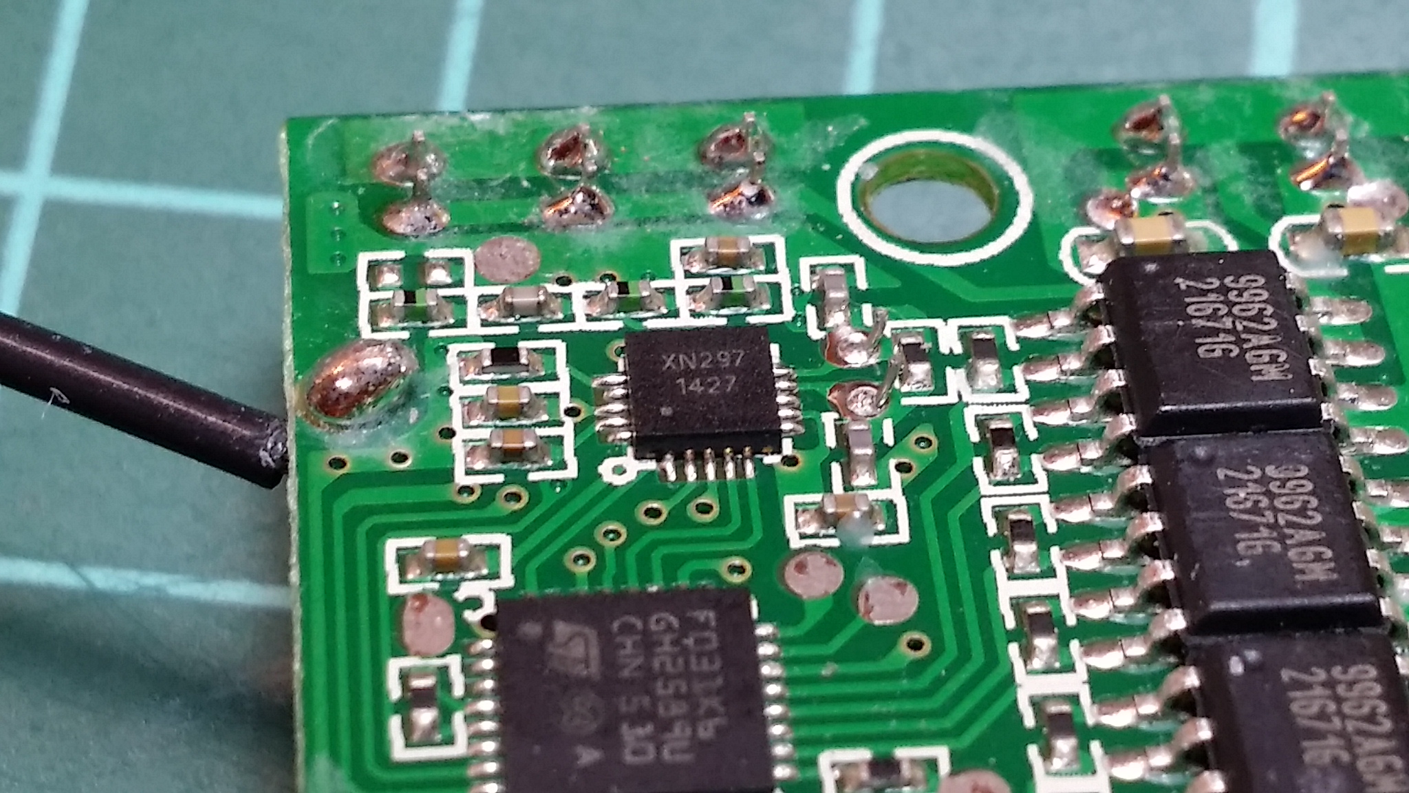

But now I got big big trouble!!
How can you guys solder wire on such tiny pin?
I will try to do it and hope it still alive after my suck soldering skill .......
Is there a easier way to do this job?
It will be much appreciated.
Probably no ;)
I suggest you to wait somebody capture from his TX, hopping the relation between TX id's and RF channels were obvious.
I asked Seby at RcGroups to take some captures from his TX's.

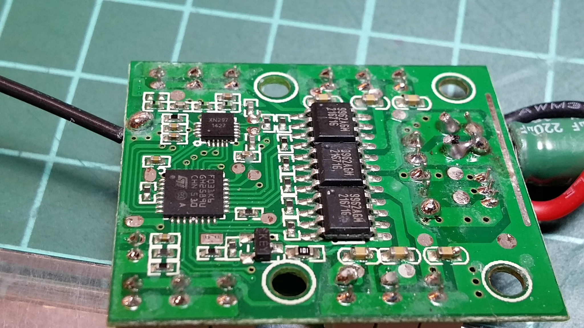

24 Jul 2015 13:31 #35912 by Deal57
Replied by Deal57 on topic which is MJX use protocol ?
A lot of these boards have test points that we can use instead of the chip pins. Can you post a photo of the board straight on both front and back?

24 Jul 2015 13:56 #35914 by Durete
Replied by Durete on topic which is MJX use protocol ?
Deal57 wrote: A lot of these boards have test points that we can use instead of the chip pins. Can you post a photo of the board straight on both front and back?
Yes, Seby is always too busy :) , but maybe he could help us at some point.
About the test points at the back side, usually they are to program the MCU, but worth to check it. A backside photo could be helpful.
