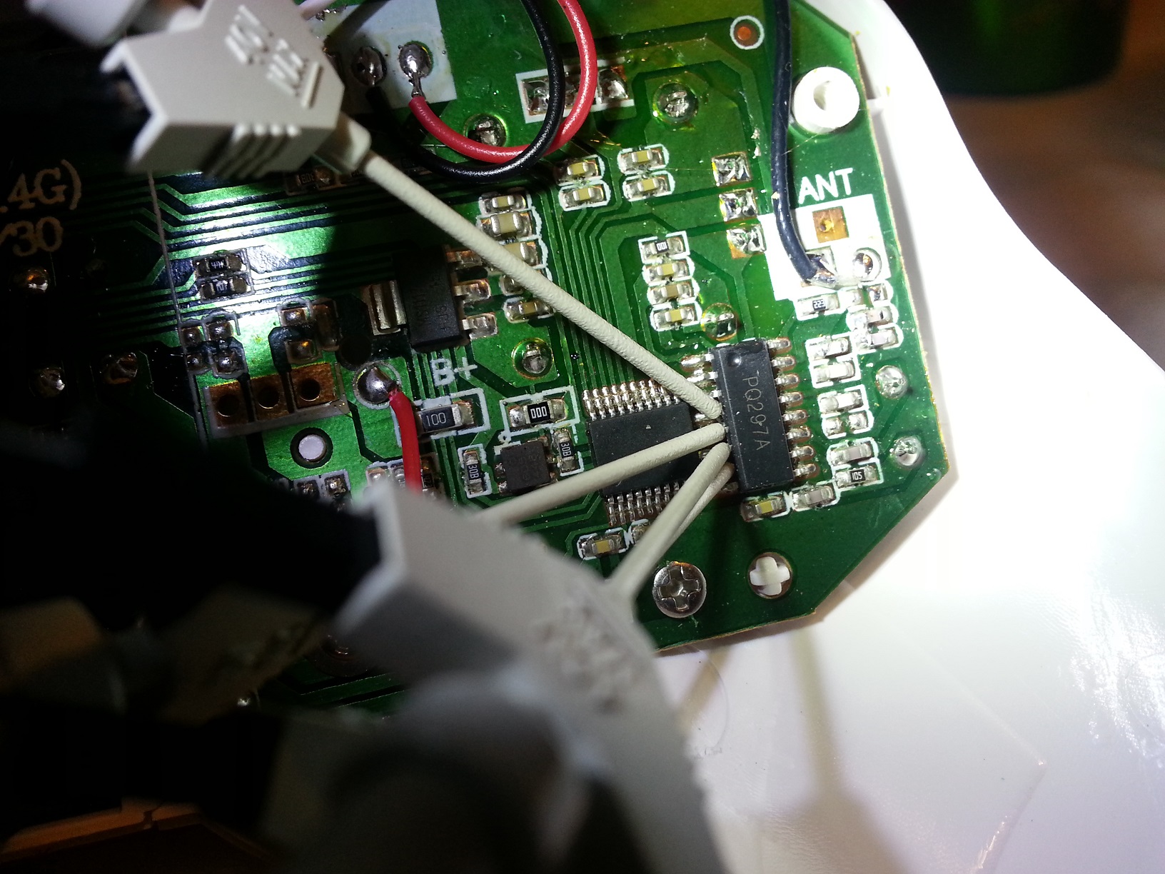

I managed to capture SPI traces from my X800 TX.
This TX is using the XN297 transceiver with a different package IC. He is using SO16 package instead the QFN20.
I took a picture of the right pin out for future reference.
CSN - Pin 4
CSK - Pin 5
Mosi - Pin 6
Miso - Pin 7
I captured 2 bind sequences, and the functions we don't have at the moment. Light control, Video and Picture.
Also I captured the flip button, and max rates at medium and high mode (autoflip at 90%) hoping to figure out how to disable the annoying autoflip feature.
dl.dropboxusercontent.com/u/14941708/X800%20Captures.rar
I could capture the bind sequence from another different TX in about 2 weeks, in case necessary.
Any additional capture needed? :)
