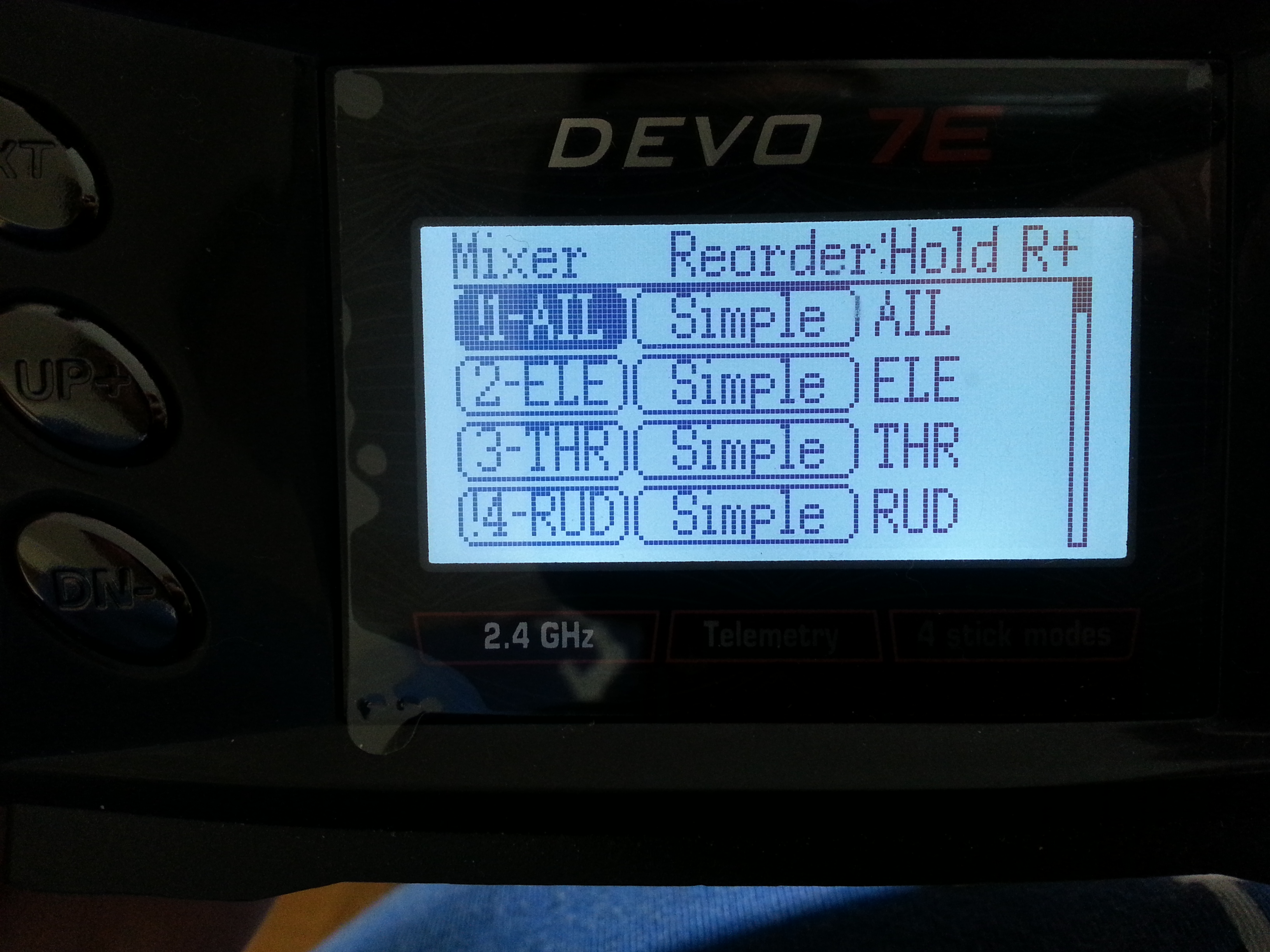

28 Dec 2014 11:11 #27289 by Durete
Replied by Durete on topic SYMA X5C-1, X11, X12
Just tested with Syma X11 :) .
Channel assignation:
Channel 1. AIL. REVERSED.
Channel 2. ELE. NORMAL.
Channel 3. THR. NORMAL.
Channel 4. RUD. REVERSED.
Channel 5. Flip mode.
Channel 6. Dual rates.
My question is what channel uses the Syma X5C-1 and the new X11C (almost 100% confident same protocol) to activate the camera?
Actually I don't have a X5C-1 to test but I have on the way a X11C that probably will receive in about 2 weeks.

28 Dec 2014 18:46 #27300 by scooterstew
Replied by scooterstew on topic SYMA X5C-1, X11, X12
hi there
Im sorry but I dont have a logic analyser.....not much use to you Im afraid....
I own an X5c-1 and X12....yes both use the same protocol.....
on X12 flying with devo 7e....the AIL and RUD are reversed.....
on X5c-1 flying with devo 7e the AIL and RUD are also reversed.....
hope thats some help to you!!!???
