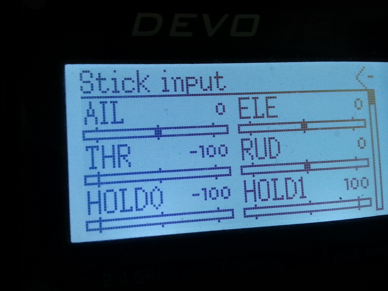

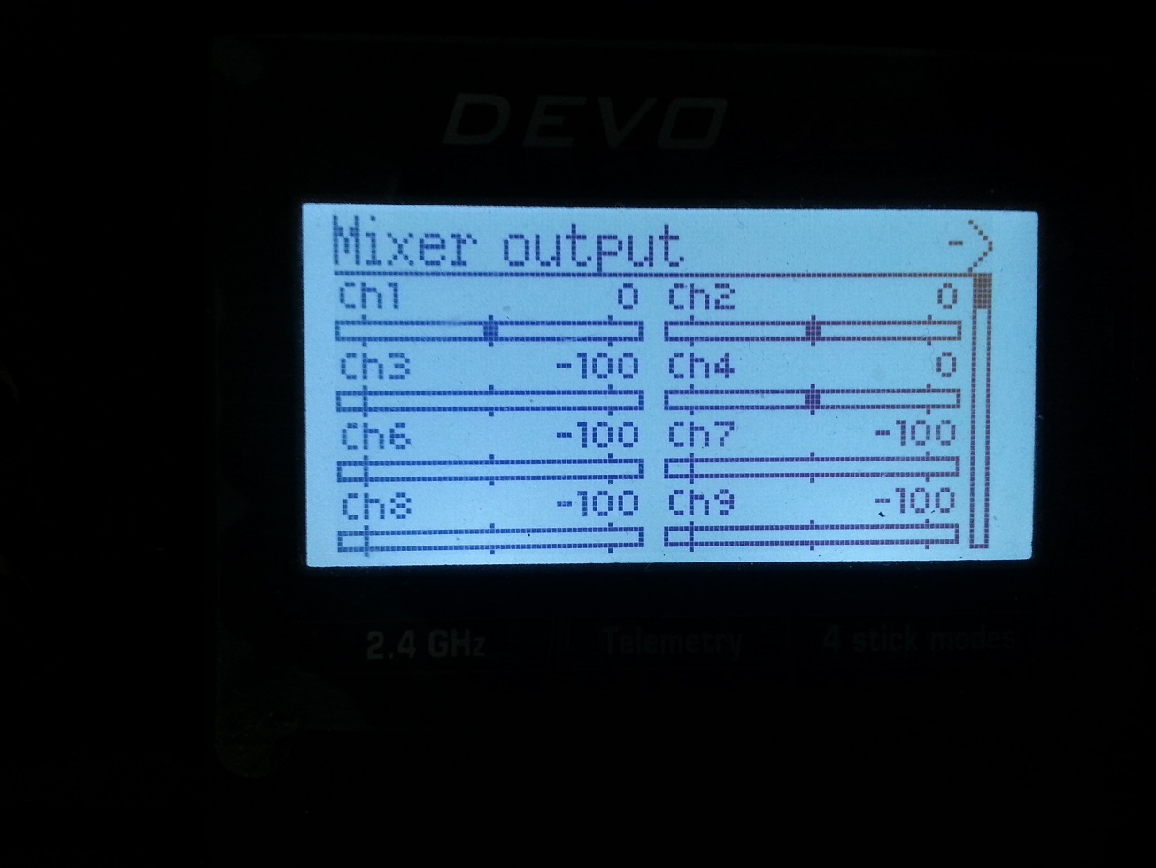

Interesting :dry: Let's see what result Durete has with this code. When we first looked at yaw drift both had it but in opposite directions. Would like to know if that's still true.
Is it a left twist as you accelerate upwards, and/or while hovering?
Does the channel monitor show the AER outputs all at zero when you throttle up?

18 Jun 2015 15:16 #34302 by greenfly
Replied by greenfly on topic HontaiTec Quadcopters (HT F801, HT F803,...)
hexfet wrote: Interesting :dry: Let's see what result Durete has with this code. When we first looked at yaw drift both had it but in opposite directions. Would like to know if that's still true.
Honestly, I can't seem to keep a good hover. It veers off to the left too quickly for me to fly it well.
