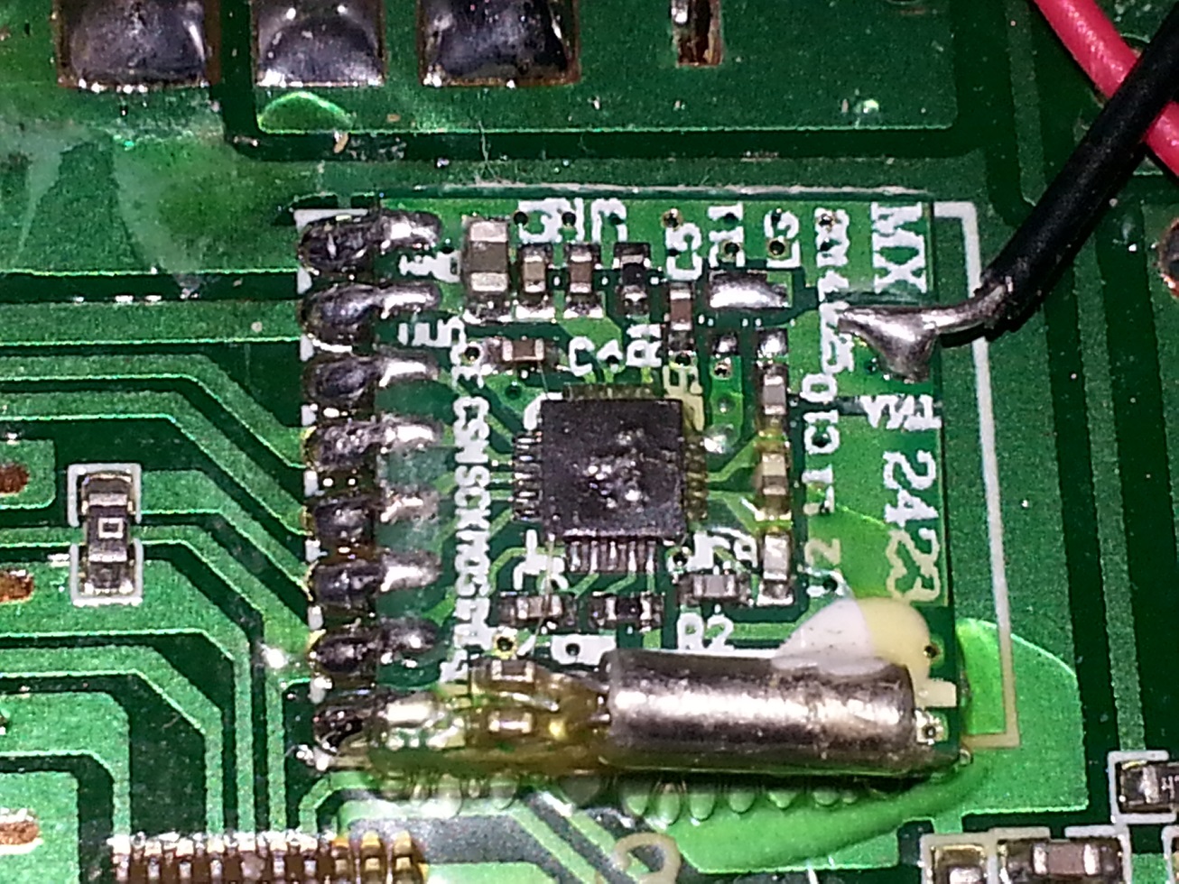

OK... moving forward. I just wanted to make sure; this RX is based on the PanChip XN297 chip found here: www.panchip.com/en/products_show.aspx?cid=63&id=333
which is ANOTHER nRF24L01 clone, right?

21 Jun 2015 23:31 #34480 by greenfly
Replied by greenfly on topic HontaiTec Quadcopters (HT F801, HT F803,...)
I'm not sure about the actual chip... (see picture) but the module is a MX-2423.
21 Jun 2015 23:42 #34481 by hexfet
mnementh wrote: OK... moving forward. I just wanted to make sure; this RX is based on the PanChip XN297 chip found here: www.panchip.com/en/products_show.aspx?cid=63&id=333
Have we been able to compile to the 7e yet, or is that still in the works?
Yes, that's the chip. It's register compatible with the nRF24L01 (with a couple extras) but not radio compatible - not quite a clone. victzh created an emulation layer that provides the ability for the nRF24L01 and XN297 to communicate.
