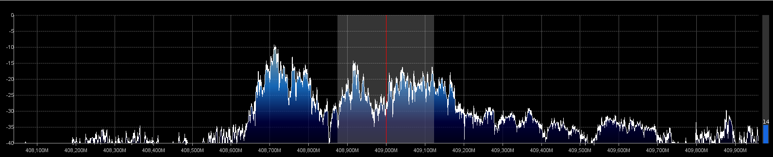

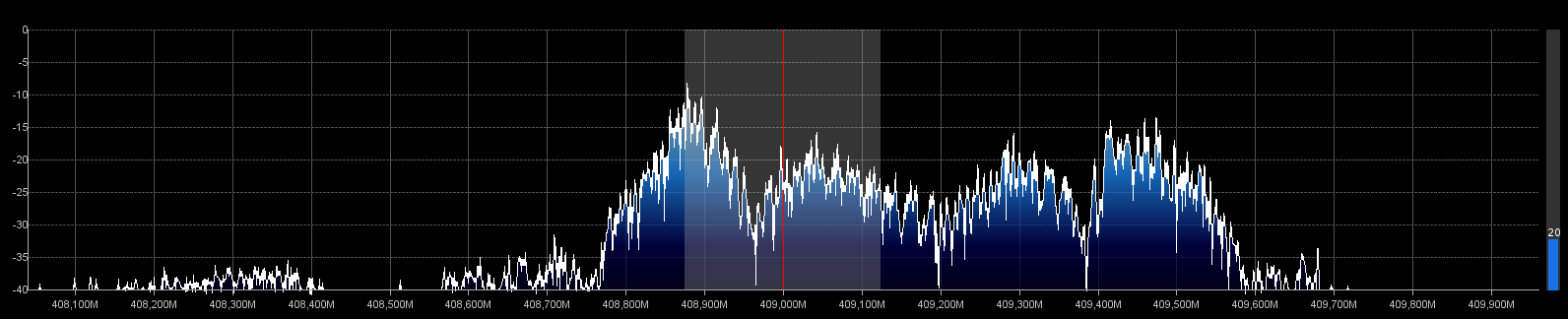

10 Jul 2016 22:17 #51531
by btoschi
Replied by btoschi on topic FQ777-124 Pocket Drone
Some updates on this topic - not too good news, though.
Need to dig into the dirty details on FM Transmission now ...
I have my own code on Devo 8S running protocol following SPI Traces (with some unknown registers) and the original Transmitter running,
sniffed both using SDR# (on linux with mono 4.2), tuned to NRF Channel 7 (MMDS LO Freq is 1998Mhz) and zoomed up to same details.
Original Transmitter:
Devo witt NRF:
One can easily spot that these signals are no way tuned to the very same frequency,
and they clearly do not look anywhere like the captures on the NRF24 sniffing page .
Someone with RF knowledge can help me out here ?
Both signals should be GFSK, but I cannot identify it at all ...
Just as a side note: the nrf24-btle-decoder cannot identify any meaningful frames (prints random garbage) - even with my Devo code.
Devo witt NRF:
