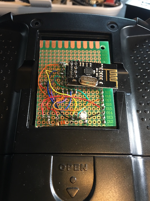

21 Aug 2016 21:09 - 21 Aug 2016 21:40 #52990 by kahuna001
Replied by kahuna001 on topic FQ777-124 Pocket Drone
I managed to put together the board and connect to my Tunigy 9XR-Pro. The problem was the NRF24 was not getting a good power source. At least I am flying FQ777-124 with a real remote now. Thank you very much BIKEMIKE. Now hopefully someone can port it to Deviation.
