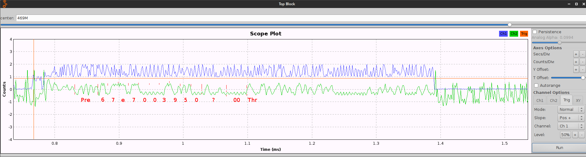

11 Jul 2016 22:55 - 11 Jul 2016 22:55 #51563 by btoschi
Replied by btoschi on topic FQ777-124 Pocket Drone
Took me a while to get there: Gnuradio showing clearly visible signal from FQ777 (thanks victzh for the hint):
I 'just' installed gnuradio on my system plus compiled osmosdr from source
(fixing cmake issue with SWIG by renaming /usr/lib/x86_64-linux-gnu/cmake/gnuradio/FindSWIG.cmake )
and then followed this nice tutorial on sniffing NRF data with gnuradio:
www.bitcraze.io/2015/06/sniffing-crazyfl...io-with-hackrf-blue/
Decoding should be easy now, hope I manage to do that before summer holiday (four days left) ...

12 Jul 2016 23:22 - 12 Jul 2016 23:42 #51590 by btoschi
Just a small update:
First of all I found a bug in my code, setting address width of 5 bytes is required for this protocol.
But still some strange differences happen - decoding the graph above shows there is no '00' byte transmitted (zero bits after three spikes are throttle),
seems it gets mixed into the 'packet control field' (which also slightly differes from NRF representation) and 1 byte CRC is requested,
but packet on air is too short with that using NRF, thus I'm pretty sure CRC is different, too.
I'm almost sure these remaining issues can be solved by adding control field and CRC manually into bitstream (and maybe sending too much zero bits, transmitter should not care).
Victz told me that the spectral images always differ between different chips without any problems regarding acual decoding.
Current decoded NRF packet looks like this, thus very similar to FQ777:
I have added annotations, control field (?) looks wrong (I'm requesting NO_ACK, thus last bit should be set) and the following zeroes are missing in FQ777 (even that they are written to FIFO),
Last edit: 12 Jul 2016 23:42 by btoschi.

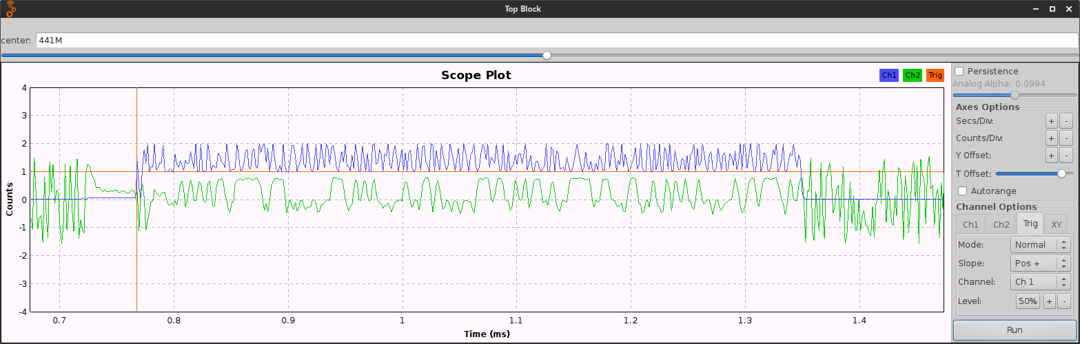

12 Jul 2016 23:50 - 12 Jul 2016 23:58 #51592 by btoschi
For me it looks like the difference happens when using Enhanced (?) Shockburst format only.
Address and Sync bytes are the same (added annotations to NRF capture, same waveform on SSV7241).
Data rate is strange ('11' is reserved value), but seems to work similar on both, scale on waveforms is the same.
Quick'n dirty measurement on waveform gives around 240000 bits per second, thus the high bit dicates 250kbp here.
I'm writing 7 bytes of channel data (CRC should be added by NRF) yet,

btoschi wrote: Data rate is strange ('11' is reserved value), but seems to work similar on both, scale on waveforms is the same.
NRF24L01_WriteReg(NRF24L01_06_RF_SETUP, 0x26); // DR: 11 (reserved)
I think that is incorrect. 0x26 is 00100110 with DR LOW at bit 5, DR HIGH at bit 3. So I think DR is 01 or 2mbps.
14 Jul 2016 16:38 #51638 by btoschi
We're both right ;)
I confused the RF_DR_HIGH - which is bit 3 in the register, thus zero when programmed with 0x26.
But RF_DR_LOW is set high, thus 'RF_DR_HIGH' 'is don’t care if RF_DR_LOW is set.'.
The 'bitvalues' in their datasheets are composed by 'DR_LOW' as high bit and 'DR_HIGH' as low bit (Just to confuse everyone :P )
This means that we have 250kbps datarate here, which is exactly what I measured.
As a note: I'm not quite sure if having I/Q values changes that,
but generally speaking sampling with 1Mhz bandwidth (RTL SDR cannot do more) cannot capture a 2MHz signal.
