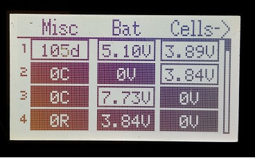

26 Apr 2016 21:59 #47271
Can you describe the location of the extra box, or post a screenshot?
Thanks for testing. Glad it's workingTomPeer wrote: I just tested frskyx3 with devo 10 and devo 8s.
all 12 channels work fine. i got rssi and voltage to rx. Also used a lipo sensor (smart port) gives total voltage and voltage of 2 cells, Plus an extra box with unknown voltage witch gives strange readings. (i guess a small glitch)
Tom
- TomPeer
- Posts: 303
26 Apr 2016 22:23 #47274
That is the minimum cell voltage. The black background means no lower value has been reported in the previous five seconds.
If you saw a value of 0.77 it implies a spurious low value might be reported, maybe as things are powering up. Might need to update the code to reject values less than 2V or so.
- TomPeer
- Posts: 303
26 Apr 2016 22:27 #47275
by TomPeer
Replied by TomPeer on topic New FrSkyX protocol
thanks, good to know. Than all seems to work fine.
Good work.
Good work.
